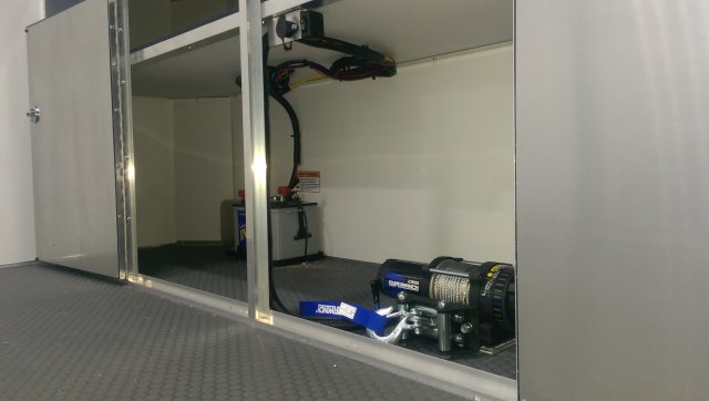

Tested winch, rock solid. Getting the front to rear charging kit as the flat four, won’t give it enough angry pixies. Bus bar for battery already in place.

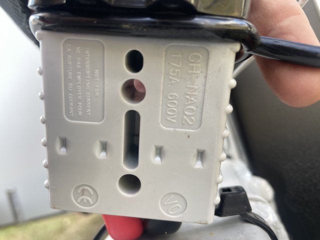

The following connector goes from the front of the trailer to battery tray.
From what I can tell this was a cannibalized 1500 amp jumper cable set. They run about 60 on ebay. Theory is undo the nuts on the clamps and attach to truck battery up front. Would run it along the left frame rail and route to the hitch from there leave some extra feet to cross over, when done i would fold the cable and store in the underside. The wireless remote is nice!

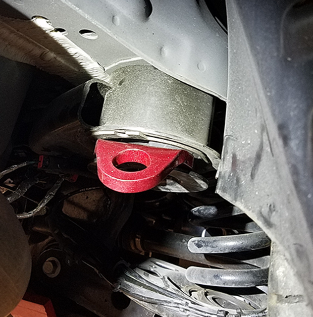

This Is for front and rear. But Id be more interested in the rear I think
TBA Machine Bolt On Tow Hook (Demon/Hellcat) HC-TOW-HOOK - Beefcake Racing
Also Im assuming the car would still pull in straight mounting on the sides like this? Or would you have to hook to both right and left sides to pull in straight?
Im looking at these as well. The fronts would be attached to what they call a bridle, https://www.macscustomtiedowns.com/collections/all/products/bridle-121936, rears would also use this. What in worried about is if it will push up on the front splitter or damage bumper. In the rear I have the cradle lockouts so adding another shim in there is ot something I want to do. I have seen people use the hole on the spring link.
4,385
10,911
I think that's the route I will go. To avoid that. may have to get the front tires on the ramp.
