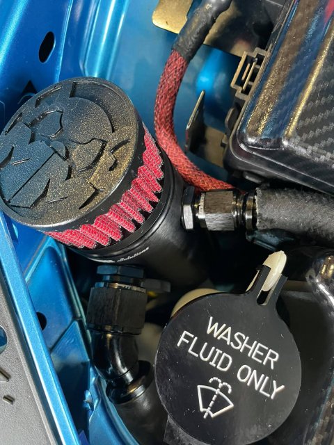

Got a little side project done today. Installed the Mighty Mouse catch can "wild" system. Did a test idle / parking lot drive of the 112mm, it drives, but needs a tweak for sure. Going to get a revision from Jeremy and then work towards WOT hits once the weather warms up a bit.

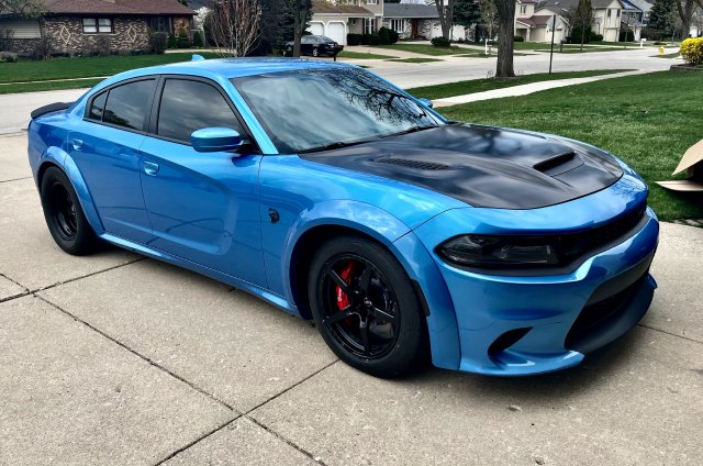

Also, changing up the look a bit. Not sure if it will add HP....
6EBEEB57-8595-435F-8437-EAD85651B82C.jpeg 00D120DC-193F-4F0A-B6C0-CE41F6212AA6.jpeg B73ABA77-1A68-40FE-B9AD-28C3350B79DE.jpeg
4,655
9,645
Is the change up a widebody kit?
The car looks amazing. Happy to see you’re making more boost sooner, that’s more valuable than the additional psi up top.

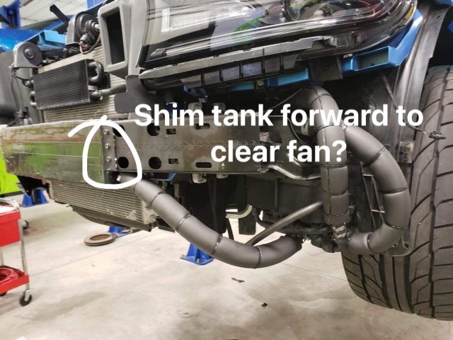

Thread Starter #319

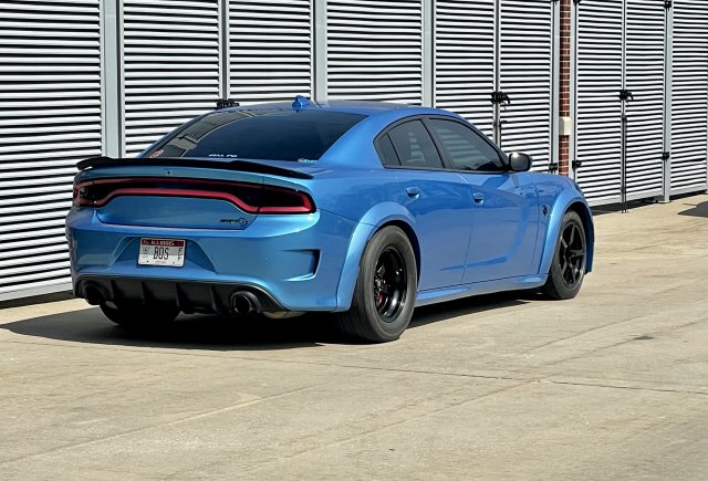

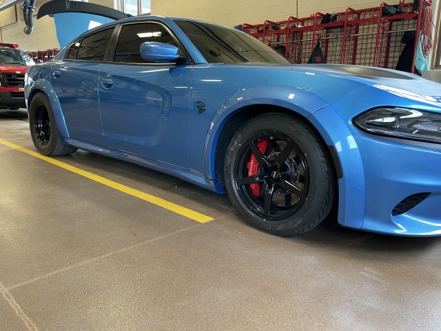

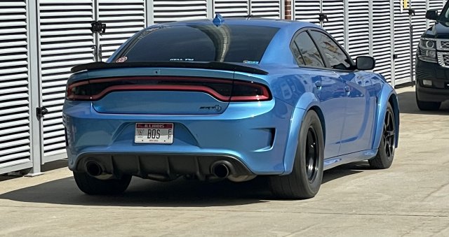

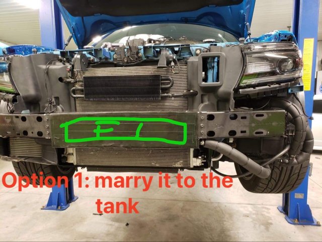

Look is almost complete:
Also moving on from the killer chiller and doing a stage 2 FI system. Have to figure out how to make it “jive” with my current bumper tank.
C4F65D6F-0D1C-4B51-9B07-94D79D122C13.jpeg 1BF08815-4674-45D9-B1FD-0AD4B89753C0.jpeg DEE809A7-181B-41D6-8989-E30AD7245DAB.jpeg 74B0F0C9-71D1-4528-8200-40E5253D0B71.jpeg
7,654
20,053
I'm normally not a fan of the WB setup, but it looks great on your car.
