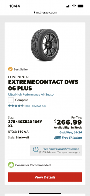

Well I need tires for my car as well. Shopped MPS4s and holy crap either they’ve gone up in price or I drink too much to remember what I paid for them about 2 years ago when they were relatively new.
Tire Rack has them for like $360 for a 275/40. I feel like I paid around $100 less when I bought my last set haha.

I just bought these for now. I don’t drive in the snow or anything but I will be driving the car once in a while I’m sub freezing temps. Discount Tire had them a little cheaper and had a 5% off promo plus a 10% off military discount, so I was pretty happy with that.
Still figuring out what I want to do for my Summer setup. My guess is things are going to get more expensive in the next year, maybe I’ll just hold out.

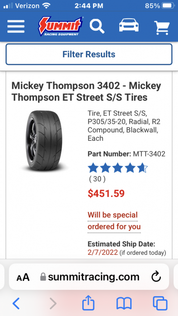

I decided to give the Mickeys one more try, in a 305 size this time on a 10.5 or 11” rims if I can get the rims before needing to mount the skins. Went with this tire. I’ll post my timers thoughts on them verse the Nitto’s once on the car and streets are warm and clean.
