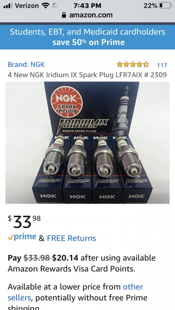

Try stock NGK plug gapped at .026”

These
