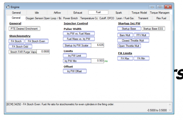

So I have been fighting with HP Tuners for a week as of today. They have stopped replying back since Friday grr.... But anyway I'm curious if anyone else has seen this issue.
My stock file on my 2018 is missing tables. I'll attach my stock file. Has anyone delt with this? If so what ended up being the fix? This was the last reply from HP Tuners "I'm starting to wonder if they added something to the newer OS and you vehicle has the older OS. You may want to consider updating it, this can be done with a dodge Witech or a J2534 tool. "
My reply back was I'm assuming this was broke during the unlock process. I'm requesting HP Tuners fix my PCM.
Does anyone know how the unlock process works? Could the unlock process cause this? If not I'll take a step back from pushing on hp tuners.
I attached a few pictures using the compare feature from another 2018. The gray boxes are the boxes I'm missing. There are 30+.

The guy I got at hp tuners that is/was dealing with me was struggling to figure out how I got the boxes to show gray. I told him compare function and it still took him 2 more emails to figure that part out…
I told them some of these are in hellcats as old as 15.
i was struggling to get afr to display correctly at idle when on a dedicated e85 tune. @Speedy! noticed I didn’t change some of the tables in the oxygen sensor tab. Well I didn’t change them because they weren’t there. That started the digging of what all was missing.
