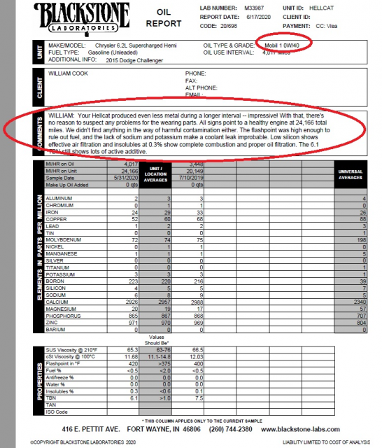

Here is my PUP 0W-40 UOA for comparison.

If you say it works for you HEMI and Fubar I think I’ll be fine too.. I didn’t specify to my mechanic use Pennzoil. But I did send him a pic this is what I use.. when he said he couldn’t find the Pennzoil.. like most other old motor heads.. he just used the Mobil 1 FS and said it should be as good or better than the Pennzoil.. and I think it’s safe to say from Hemi’s analysis it’s every bit as good as the Pennzoil

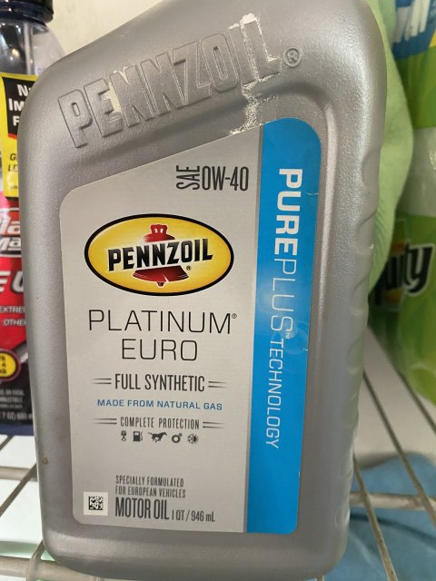

Well they’re phasing out ultra platinum.. so does any other oil products even use the term 12633? Correct me if I’m wrong but wasn’t that only on the SRT version of the oil? Which has been discontinued like over a year.. even this.. E6D9836F-A783-48DE-A0AD-FF8D693F2BD6.jpeg I use this on the charger.. and on the label it doesn’t say it’s rated ms12633 but some say this is better than the SRT ultra plat or whatever..

Valvoline has a 0w-40 that meets FCA spec.

I believe that is formulated for extended drain intervals...very stout oil for sure.

Yeah, I’ll switch back over to the pure plus next change.. I cringed a bit when my mechanic said he used the Mobil 1.. I was firm with making sure he drained the oil cooler but didn’t specify make sure you use the pure plus pennz... but after seeing HEMI’s analysis I feel better.

Mobil makes great oil IMHO...don't think twice about it.
