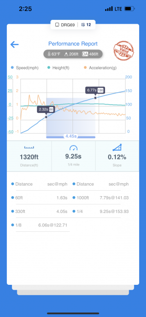

had a little more fun over the weekend. leaving off idle in 2nd. I think I have the right setup now. get that 60ft down to 1.3 and I think I get a new banner under my name.
