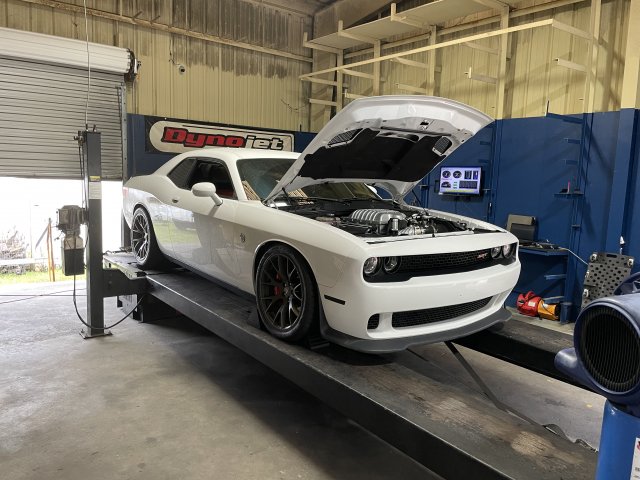

Well, I finally got a chance to put my car on a dyno today and I have to say I'm happy with the results. I have a pretty simple DIY setup on a 2015 m6 hc consisting of incognito lower, double pumps, afe intake and Dusterhoff ms109 tune. DA was 1130 and raining. She put down 751whp at 6350 rpm and 780whp at 6550rpm. 1st pull had the afe pre filter and rain guard, second pull was filter only. I've had this setup for 3 years and got the race gas tune last year. Pretty stoked to say the least👍

Congrats!!

Very nice. How much boost were you making?

Like 13.3 but the air was not great. I’ve seen above 14 in negative da

Looking good!

Wow those are some stout numbers geeez thats like 950 BHP. What tire u gonna run on the street? Gets sketchy at 800+ whp cause it will make more hp on the street.
I found when I hit 800 whp the MT SS or the Nitto 555R2's couldnt keep up..... Needed the street R's in a 17 inch.
Those were good to about 900 whp I found then id spin still slightly. Anything past that the Pro radial is best but that was on my Turbo Mustang never ran a 15 inch on the Challenger but guessing its similar.

Currently running the 555R2's. There only a few months old and I'm pretty happy with them. Sold my street Rs when I came to the conclusion (speaking for myself) drag racing an m6 is more or less like pissing in the wind lol. Seriously tho, felt it was hard on the car(trans) so I sold the mantic triple and tires and just decided to keep it a nice street car.
