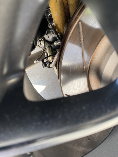

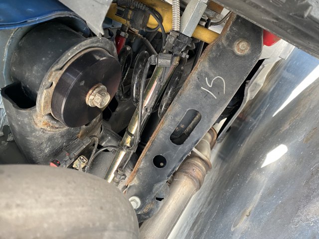

I can give you a street review. I noticed almost no change with the cradle lockout on the street. Arms stiffened up the rear quite a bit, but doesn’t bother me at all. I daily drive the car. Big plus is setting camber closer to zero for the rear tires.
Just locked out the cradle and put Nigel’s toe arms on.
E3D3D34D-1BDD-48D4-968F-B3455FB837E0.jpeg EED25E28-AA1C-415B-B91F-ED3B0871E0EF.jpeg

What difference did you notice on the track with the cradle lock out kit. Install looks like a PITA LOL.

If you think that’s bad, check out the instructions for the solid aluminum bushings.

No squirming in the rear . I'd say the rear cradle can move around about 1/4 inch . The lock out kit keeps it square . But on the street the rubber is still there to absorb the vibrations .
It's pretty easy to install . The worst part is getting the limiting plate off the front of the cradle . But do as the instructions say and drill it ( I used a small bit to make a pilot hole then went with the bigger bit ) . Once you split it , it will pry right off . The rest is pretty straight forward .
You could always wait till challenger fest and I will do it for you right in the paring lot !

Completely ignore the instructions lol. I have a little instruction write up that made it easy if you want it just PM me.

Exactly. That will be eliminated . I call it torque shift . I will to let you take my car for a spin to see the difference.
Either way it is a pretty easy install and worth the price of admission.
