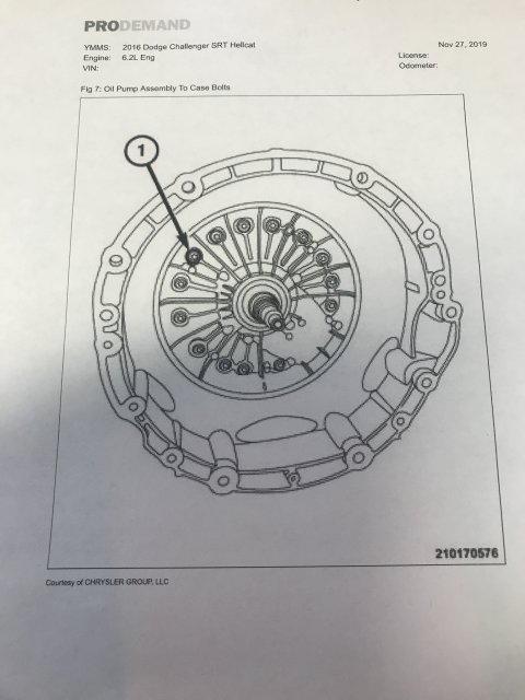

HERES THE PUMP BOLT KIT I SPOKE ABOUT THAT YOU WILL NEED IF EVER REMOVING THE PUMP BECAUSE THEY ONE TIME USE ,THERE IS ALSO A PROPER TORQUE PROCEDURE WHEN INSTALLING THEM ,
IN ORDER TO SEAT THE OIL PUMP ASSY PROPERLU TIGHTEN BOLTS 1,7 AND 9 TO6 N.M ( 53 INCH LBS) ,THEN WORKING CLOCKWISE PATTERN BEGINNING WITH NUMBER 1 TIGHTEN TO10 N.M( 89 INCH LBS ) THEN WORKING IN A CLOCK WISE PATTERN TIGHTEN AN ADDITIONAL 90 DEGREES
As you can see the bolt kit comes with new from seal and input shaft oring image.jpg 3399EE25-7961-42B1-9422-FBAA2377A468.jpeg
As you can see the bolt kit comes with new from seal and input shaft oring View attachment 7510 View attachment 7511
