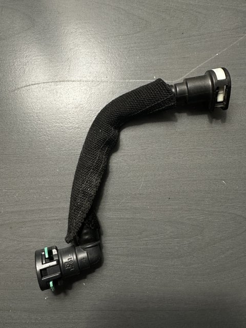

I’m still trying to figure out if the braided line is part of the hard rail or separate that can be back ported to earlier cars. Do you know @jonx96? Since you’ve had the engine out a few times

The line that connects to the fuel rail, its braided in 2018+. Can that disconnect from the fuel rail at the firewall? On 2015-17, it’s a plastic piece, and can be disconnected at the main black metal fuel line. Here’s a pic of my old one. White clip connected to the fuel rail, green clip connects the the hard metal fuel line by the firewall that goes back to the tank

I’m trying to determine if that piece (which is now flexible) is built into the fuel line runs under the car and up the firewall now, or if it still connects to the hard fuel line (and I can replace my plastic one with it)

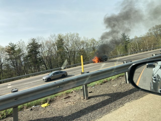

Saw this on my way home from work earlier today. I see witness marks of car fires on the highway often, it more common then some think. Everyone just drove past it like it was a normal thing. I can only hope it was empty, there was no stopping in the 90 mph traffic I was in. I’m sure there will just be another black spot there on my way in tomorrow.

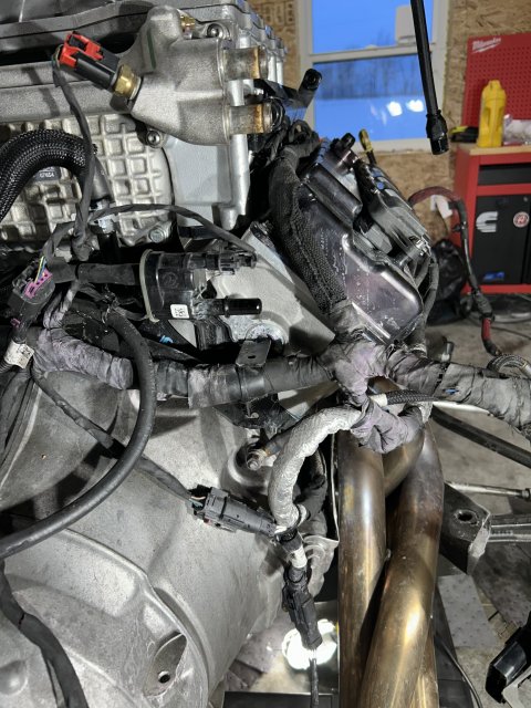

You sure that’s part of the fuel line and not this part that plugs in here View attachment 164265
If you don’t see what part I’m talking about let me know. Right under the supercharger to right. Only part it looks like itd go on
