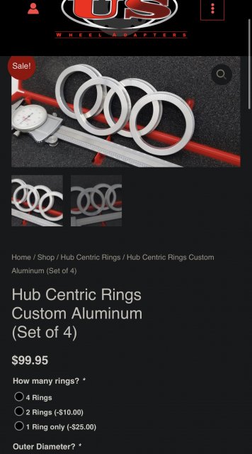

And one thing a lot of people overlook. You need to get hub centric rings for the insides of ALL aftermarket wheels to make them hub centric so they actually rest on the hub and not the studs. I have the specs and I ordered them for mine and have them in my wheels. I forget the company I used, they’re from Texas great people. Pretty cheap and quick turn around time. I think @16GoManGoHC2 gave me their info

I put a dab of rtv on the aluminum rings and put them inside my wheels in the back. They ride and align right on the hubs now. Well, the back I have custom 14mm hub centric spacers as well and longer wheel studs I put in

Measure on your forgestar as well with calipers, please. I had special rings made, were $100 for a set of 4. Look at what the hub says on my box. That’s not the hellcat hub size. They 100% do not sit on the hub.

I used US wheel adapters. They had the forgestar wheels in their system already so knew the size, found the email.

Sure, with the lugs you’ll probably get them centered. And then all of the stress is on your studs and not distributed on the hub. That’s the whole point of hub centric, for the load and alignment to be on the hub..

Here’s the ones I made, they locate the rim same as stock does. These are custom diameter hub centric pilot for Race Star rims. I made a few sets in different widths, 10, 14, 18mm, work great.

I had stock bore hub centric spacers made (with the lip) and then got the rings made for the inside of my forgestar wheels. This way I can use the spacers with my stock wheels still
