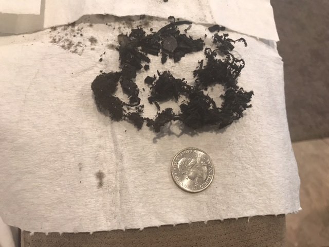

Yes belt shredding was not good sucked pieces of belt into Procharger tried to get it all out but after new belt picked up a miss at last half of track but by the time I pulled into pits it was running good thinking some got in motor pulled plugs today compression good 180-190 cold so tomorrow l will pull intercooler and clean out

Pulled the intercooler today found just a little bit in it (ha ha )

You mean that went through the procharger and was caught on the intercooler grid?

Part of it went all the way through inter cooler and I believe that’s what caused miss in engine for 3 minutes or so at end of track but it cleared up
if you looked in bottom of intercooler you really couldn’t see anything
so I made a blower pipe so I could go through the top and blow downward
all the across Top hopefully I got it all
