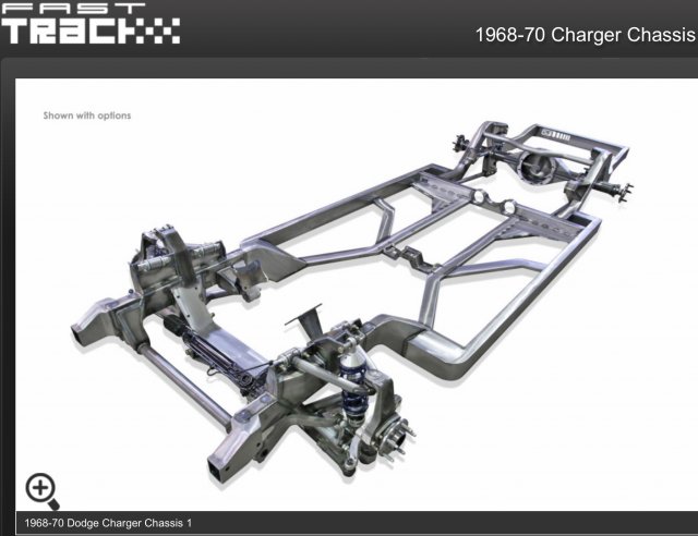

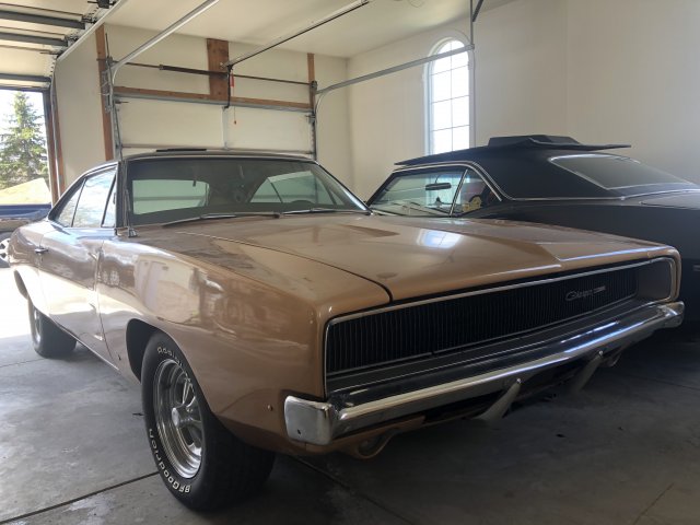

I joined this site to learn what people like and dislike about the Hellcats, in particular the motor. I have a 68 Charger that i’m prepping / researching to do a restomod on. I’m on the fence on doing a Hellcat create engine or going with built 440. I’m ordering a complete chassis for it from the Roadster Shop and need to make a decision so they can put the correct motor mounts and the correct rack. If anyone has any experiences or insite on the Hellcat swap good or bad it would be appreciated.

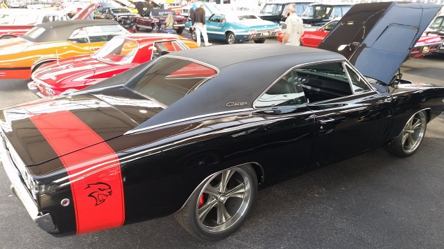

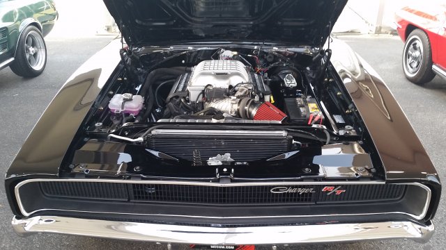

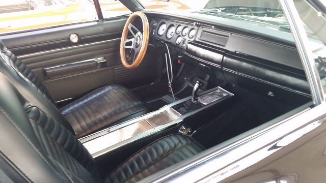

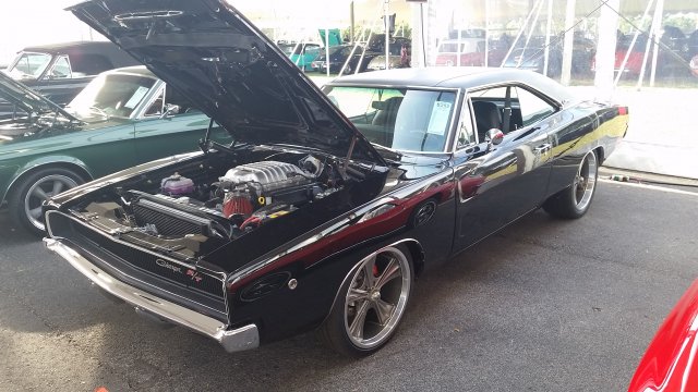

I was in FL for biz this week and stopped by Mecum. This car got my attention for sure - done nicely. It hammered today for $150K ($165K with buyers premium).
Good luck with building your 68 Charger !! 20210115_093039.jpg 20210115_093047.jpg 20210115_093113.jpg 20210115_093126.jpg
Thank You
Is that a 69 Camaro in the last picture, sitting next to the Charger? The one with the tunnel ram intake? If so, what's going on in the headlamp area there? Kinda hard to tell from the angle of the photo...
11,710
19,827
high rise intake manifold and double pumpers.... yum
