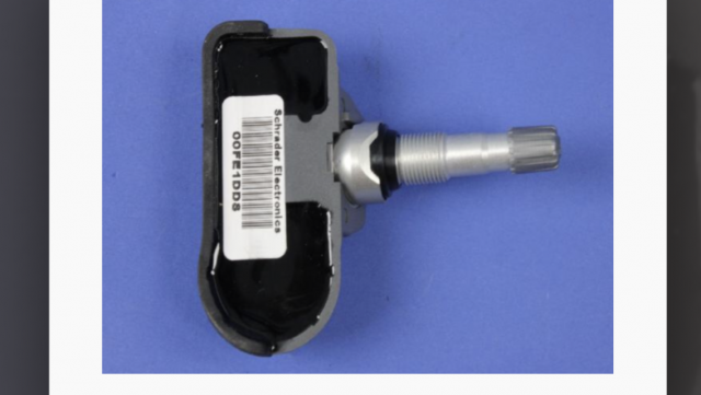

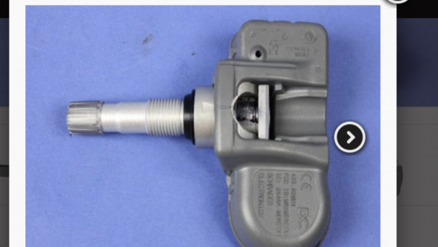

The TPMS sensor is not really part of the valve stem or working part of getting air in or out of the tire, it’s just clipped onto the stem for the ride. I’ll see if I have one out in the shop and post a picture of it. You can actually separate the 2 easily and snap them back together.
So you were not using OEM sensors? Yes take a pic. I wanna see. OEM sensors do not just clip on and off. You have to remove the cup , gasket , nut and cap to get the T bolt (VV stem) out of the sensor. Also if you have not dismounted the tire yet, how do you know what happened? I would relly like to see the broken parts or whatever you find, please.
3,705
8,737
Thread Starter #28
Yes, oem sensors, Soon as I change them i will post pics. I purchased 2 new ones from dodge to put in my 17” rims and if they are the same as these they are 2 pieces, that’s where I’m making that association.
3,705
8,737
Thread Starter #29
Here’s a picture of one, see how their clipped together? I had a new one come apart in my hand installing it. I’ll have a new one in hand in a few days, tired will be here next week as well
3,705
8,737
Thread Starter #30
Another pic of back side, sensor just slides onto that flat clip, held in place by rim once installed
I just installed 6 of these and they do not just clip together. So, I have no idea what you are talking about. Please, be sure and show us pics when you get the tire dismounted.

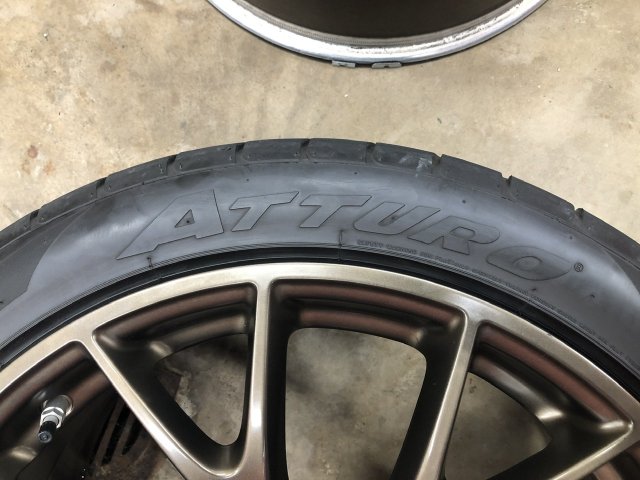

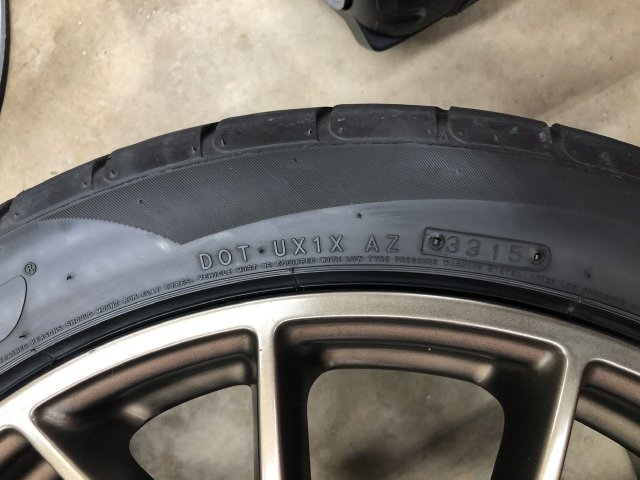

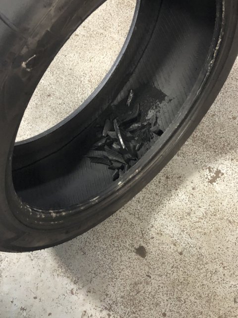

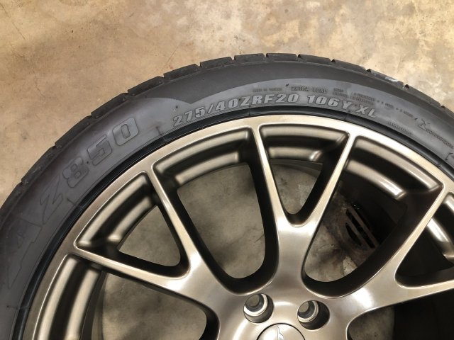

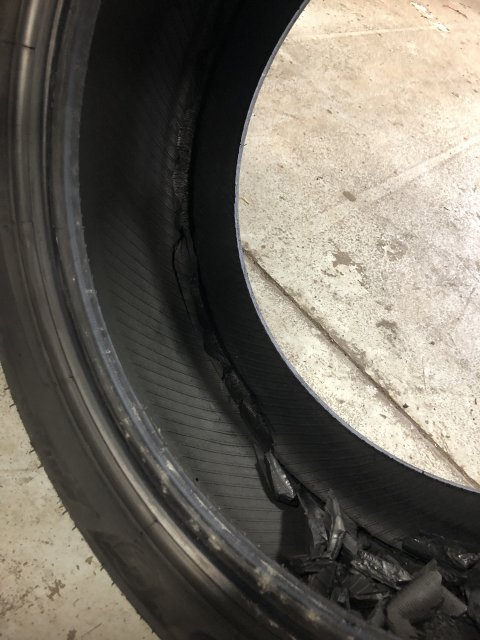

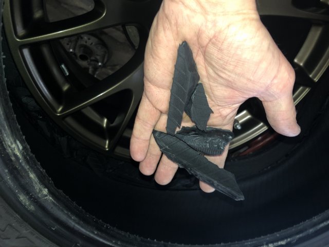

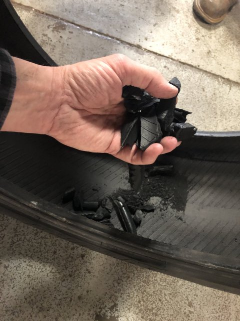

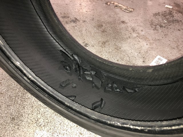

Turns out TPMS sensor was intact, tire was literally shredded inside, manager of 25+ years at this large tire facility never saw anything like this before. Man am I lucky I didn’t have a blow out at 175+. Moral of this story, NEVER assume something as critical as a tire problem, it could cost you dearly.

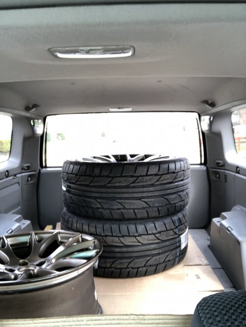

New Nitto 555GII’s went on this weekend.

That's some scarry stuff right there. No curb or other impact that you're aware of? Manufacturing defect is my bet then.
3,705
8,737
Thread Starter #34
Nope, not since I owned it, but the front tires where on the car when I got it, 2015 date code on them. That was the inside edge of the tire not the outside

What brand was that tire?
Shit brand lol, I don’t recommend them
I NEVER buy shit brand tires, here’s a prime example of why

I'm putting the same NT555G2 on front tomorrow
