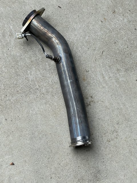

Cornerstone supplied bypass modified with V-Clamps to provide easy on and off install for preparing for track days or bringing it back to normal. It sounds so good without the Cats. Easy to bring back to normal for street use. Otherwise after fitting up the Cornerstone adaptor etc into the existing exhaust, it will become basically permanent.

Did you work with Cornerstone on what length the flange is at, or did they kind of locate it close and you have to have the mating flange on OE pipe modified to suit?
8,285
51,437
That V-band mod is a great idea! I need to file that away. :sneaky:
The best way is to let a good exhaust guy do it.
It has to be on the money and both the Cat and the by-pass need to be identical of course. Kind of tricky. Careful with the sensor threads if you exchange them.
