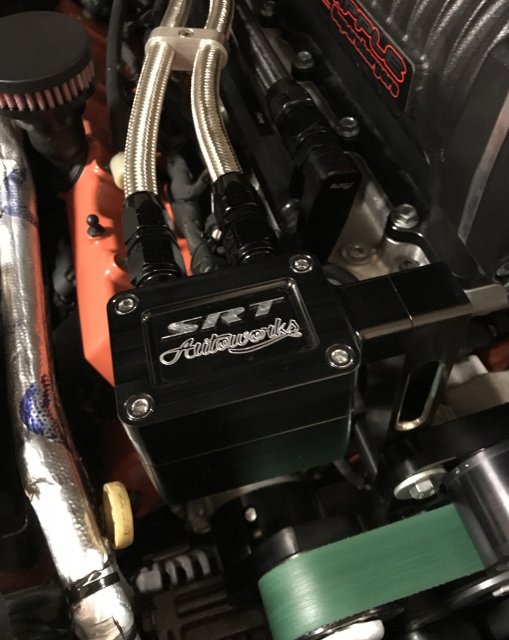

One and done. Might as well make it look good while you’re at it.... 5B0CC386-BD9F-4D20-BAB4-99307F3FD098.jpeg

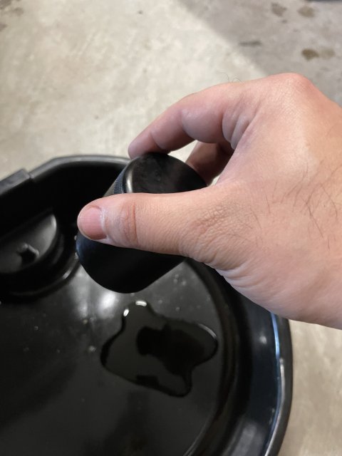

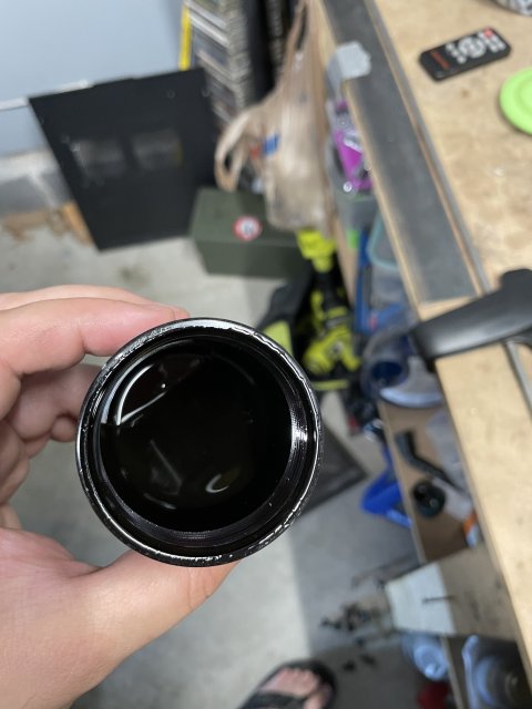

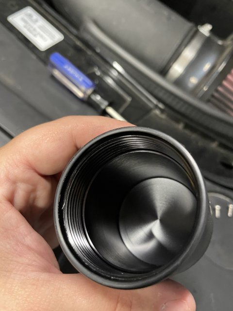

Ive converted to the Church Of Catch Can. I guess once you pass a certain amount of boost no matter the baffles or the design of the valve covers you will get some oil in the system going back into recirc... When I was cleaning out the super charger, there was oil coating a lot of components, and I only had the drivers side can. Since that was in the air charge it was 100% making its way into the chamber. Where was it coming from? Had to be passenger side. Now pushing about 18psi on a great DA day I found this…
F3F1F385-A5A1-426F-B37A-EA65EA503873.jpeg 6E78EA17-9A12-4CAC-9A6A-F169C9D21195.jpeg
First oil change on the new pulley. The above was from the passenger side. However bone dry on the driver side. 🤷🏻‍♂️
Would rather have it in the can then in my chambers.
