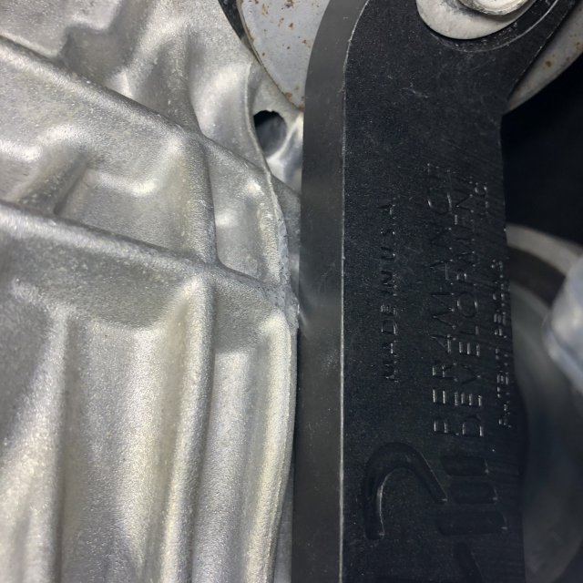

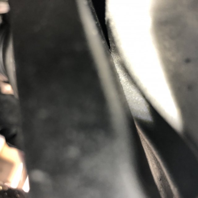

I got the Race Brace & installed it, there was some clearance issue on the passenger side arm of the brace & side of diff. , I grinded down a little on 1 fin on the diff & a corner of the brace arm & it was good. I talked to Bray about it first because I didn't want to be grinding on the brace & not be able to return it if it didn't work, he said go ahead & I could totally destroy it & he would still take it back if I wanted to. Told him he should move the passenger side arm out 1/4" in the future & would be better.
Also nowhere in the instructions does it say you have to drop the exhaust (stock exhaust anyway) to get to the passenger side bolt on the diff (AEV in the way) to bolt the brace on, don't have to drop the whole exhaust, just have to lower it down from the back & middle.
All in all, I like it & that SOB is solid for sure.
