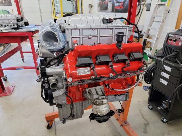

I forgot to take a pic of the engine with the wiring harness all clipped on( it was a late night) . @DemonSRT could you post a current pic of the engine . . Thanks
DemonSRT
#1457
561
1,764
Kawartha Lakes
NO! Your disturbing my ugly sleep!
Just kidding.:ROFLMAO:

Some install pictures would be cool.
Thread Starter #1,674
I will take some for sure .
