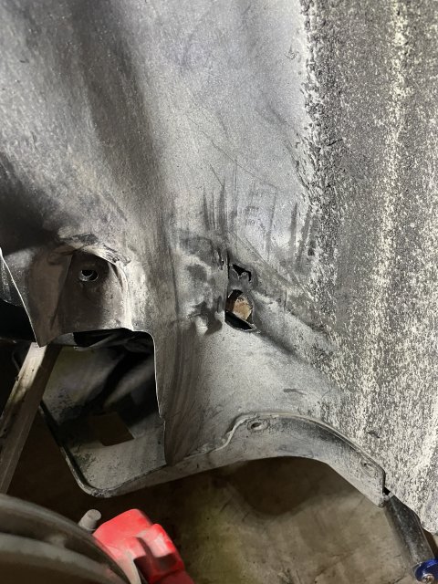

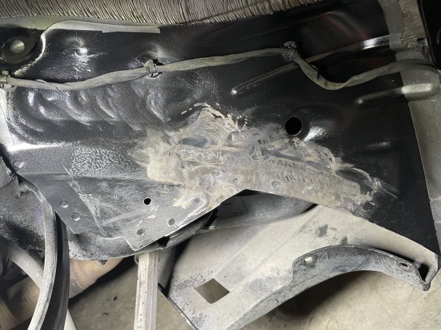

Did all this and still not enough room.
1E80AB55-1B28-4D85-8828-839971D3C53A.jpeg 41FB02E0-98F0-495E-AE3C-9010B6CF6B15.jpeg F4BE7A5D-5B72-4CED-A3ED-4683016FA83C.jpeg 01D0CC2A-C847-41CA-95C7-0634C1C31F84.jpeg
What else should I bang in?
