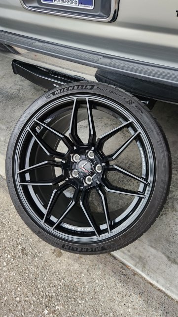

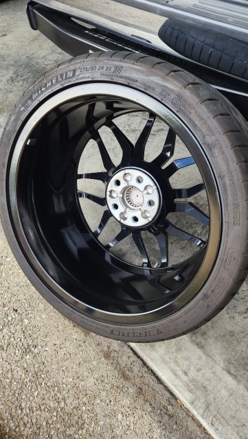

PSA - Be mindful of the tire dressing you use. I'm not sure if the previous owner put this stuff on the car, or the dealer I bought it from, but man it was terrible.
I noticed when I washed the car the wheels looked a little dull. Looked closer and saw some kind of film that was worse in the barrels and on the calipers. Car wash soap wouldn't touch it.
My OCD was triggered so yesterday I pulled the wheels to clean it up. I always start with the least aggressive cleaner and work my way up. It felt kinda greasy so I started with hot water and dish soap, wouldn't touch it. Simple Green diluted didn't touch it. Simple Green 100% didn't touch it. Dayum.....finally went to paint thinner and THAT cleaned it up but what a freaking mess. Someone had just sprayed tire dressing all over everything and it was nasty stuff.

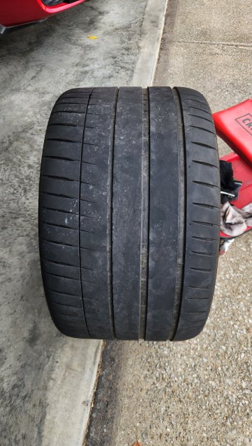

Took about an hour per wheel to get them cleaned up. Then I ceramic coated them for good measure. Rear tires on this thing are steam rollers.

Bet it was some crap the dealer slathered on. They must have used the same shite pre-delivery on my Genesis, my wheels & barrels looked exactly like that & the detail shop said it was a huge PITA to get off.
Those are some huge meats out back [ohcrap]

Orange clean and goof off are my go-to for stuff like that

I went through a whole quart of paint thinner. I'd hate to see the bill for a detail shop to clean it up.

My last resort before laq thinner is "Awesome" spray cleaner from Dollar Tree. I was afraid use it on painted wheels, but it appears, so far, to not be a problem. I keep it handy on the shelf in the garage with all the car stuff. Cheap too! $1.25/qt last time I bought it.

If yer resulting to lac thinner..(I use starting fluid as well)..then it's a long messy process..no off the shelf cleaner will work..slow careful process...been there..done that..

Yeah I get super careful with anything past paint thinner.....can muck something up quick if you're not paying attention.
