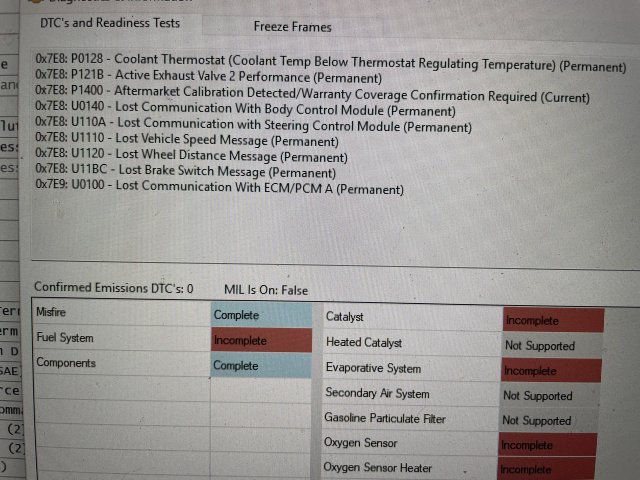

I check my dtc code with hp tuners this is what I got could this be problems with the BCM? And if so why cant you buy a bcm and they could program it with my car's vin#
5,915
39,466
Could that be from trying to unmarry and do you have to do some kind of reboot or reinstall original information?
