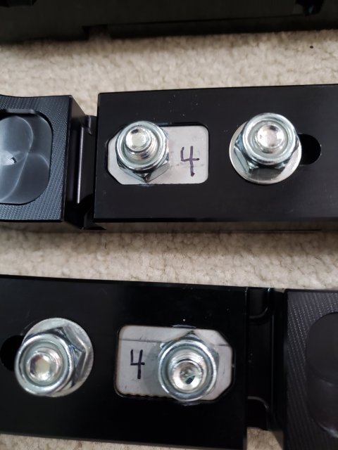

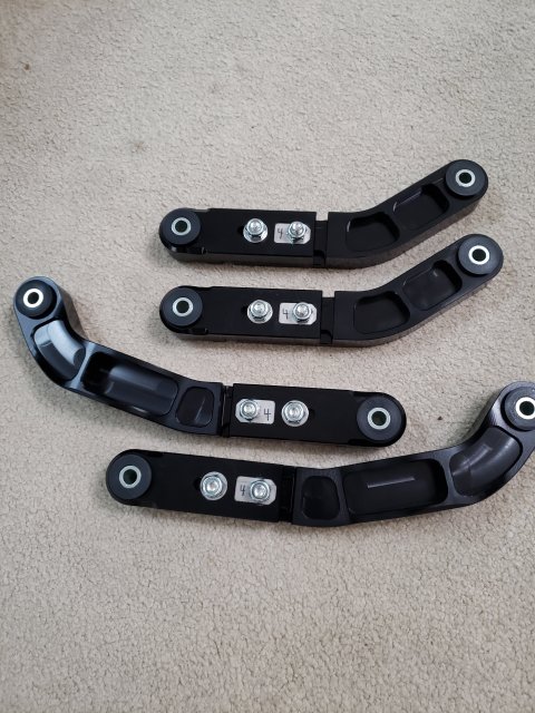

Going to do my arms this weekend or next. I decided to start off with the 4 tabs 20220518_173526.jpg 20220518_173529.jpg

What I remembered most is I needed a few 18mm’s of various types and a few extensions. Good luck, easy but a bit time consuming. Dropping the cradle the way to go imho. Don’t forget to unbolt the brake line on the d/s. Also, if you’ve got a rear strut tower brace don’t forget to secure the nuts holding the shock bolts which also hold the brace.
Edited to add, now that I think about it I did cut the one bolt on the drivers side on the upper front frame side arm. Cut from the bottom up, not through the wheel well as others. I wasn’t going to cut my sheet metal either. Thanks for the reminder fubar. I’ve dropped the cradle before to do the BMR Cradle Lock Out Kit so I got confused for a second there.

What was interesting in the instructions is it said you can make all your camber adjustments with the long bar (one next to spring). I would think they both need to be the same but that isn't how it reads. I just started with them both the same
That call gets interesting. I would start with both the same. If you run into toe adjustment problems you can start playing with the “front” arm, but that is a dark highway. I spent maybe six weekends all together screwing with the alignment and those tabs, since I have the whole set. But changing out just one of the two sometimes returns surprising results, like N/C!!
