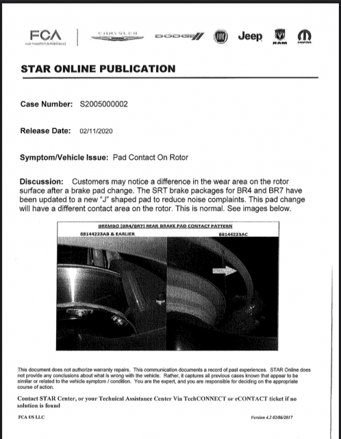

So from another forum, I think the answer is apparently this was done for noise? Not sure I buy that buy hey there is a service letter.....This is super lame! I can't believe that they would make such a b.s. change! I am not going to lose anymore sleep over this nonsense and just order up PowerStop Z26 replacements which I was thinking about doing anyway for dust reduction....This is a HUGE disappointment.......This is beyond retarded!
Edit: I ordered up my Z26 replacements tonight. I am glad that I don't have very many miles on the car yet...

The big brake brembo kits on the HC and other CAN sometimes make noise. Both my T/A and HC did BUT it was from the front brakes. Usually when they were dirty and it was damp out. Few squeeks or squeals but nothing that would last long It sounds to me like this is a "normal oil use is 1 qt per 500 miles" routine

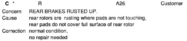

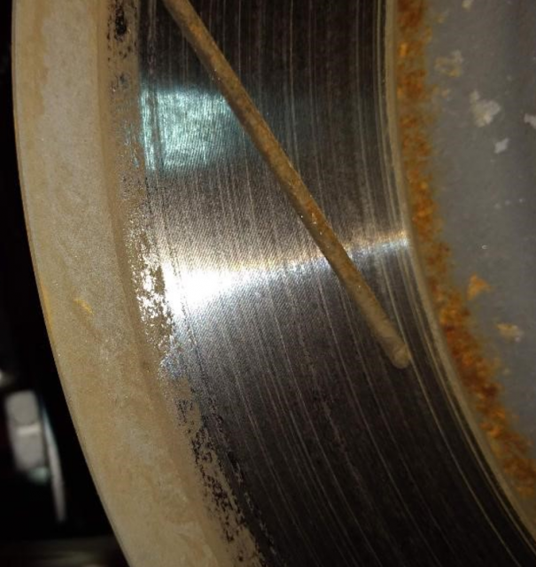

@SNeal5966 I agree with you that the star case is bull@#*$. I have a late build Redeye of 11/19 and with 14 miles the rear rotors look like they came off the Titanic. My guess is they'll eventually silently supersede the AC revision pads back to the normal pad design and call them part number 68144223AD. If they're truly worried about noise then they need to change the supplier of the rotors.
I took my cat in for other work and mentioned the rear pad contact area and rust.
This is a snipit from my work order...with a typical "No problem found" response.
No worries as I've already purchased new Power Stop pads for the front and rear along with new rear rotors.
Wow that is a shame they called that Rotor normal......I mean that thing really does look like it has been sitting on the titanic.....LOL Mine aren't like that,, if you saw my pictures of it at the beginning of the thread. Mine are clean and no rust but pretty soon I will have the full sweep surface with the PowerStop Z26 pads.....
