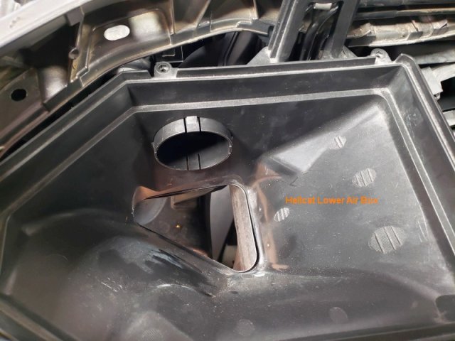

I'm trying to visualize this and can only assume it directs air into the triangular shaped opening in the bottom of the intake air box?
Has anyone seen any pics of this ?
Thank you !

In an older Hellcat air feeds air in from the bottom via a triangular opening sealed with a foam gasket and through the headlight eye catcher. On the 2019 and newer Hellcat/RedEye and 2018 Demon they all feed in from the top Via a hood Scoop as well as the other 2 ways. 2017 scat pack hellcat air box 00.jpg

I wasn't aware the older Hellcats incorporated intake air from the wheel liner and thought that feature was unique to the Red Eye & Demon. Thank you for clarifying that and the excellent picture as well. PS: I've been following your performance at the drag strip and it's OUTSTANDING !!
