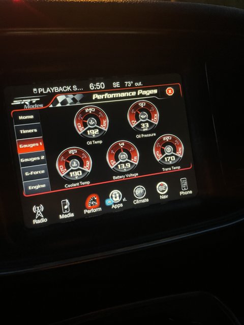

Yesterday while driving the car under acceleration would shut off and I would get a red lightning bolt in the dash. Upper left. Some have said the alternator could be going or that the throttle body needs a re-learn. Has anyone encountered this? While it happened, I put on the performance pages to see what was going on and car looked healthy.
