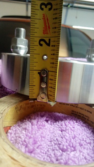

Ok...I found the info and pics from the other forum regarding the spare tire debacle.
This is what he told me about the spacer, and these are the pics he sent me. He has a 2011 SRT 392, and his car came from the factory with a spare and spacer to fit over the front 4 piston Brembos.
Many thanks to Roostking....not sure if he's on this forum or not.
"3 inches to the tip of the lug, Spacer itself is 1 3/8 inches thick "
This place sells similar spacers you just have to pick the correct thickness.
https://adaptitusa.com/dodgechallengermagnumchargersrtsparewheelspacer.aspx

You'll want to get hub centric adapters if you go that route. Lug centric will have your car shaking more than a one-piece driveshaft. I've purchased many wheel adapters from here over the years:
http://www.ezaccessory.com/Hub_Centric_Wheel_Adapter_5_Lug_115_to_5_Lug_115_p/5115-5115hc.htm
EDIT: I just noticed those are only listed as 1" thick. You can have them made to order with a specific thickness here: http://www.ezaccessory.com/Wheel_Adapter_5_Lug_Custom_Up_to_127mm_p/5000-5000.htm
Great info, thanks! And that's a nice sale price too :)
Just ordered a pair. Had them add the hubcentric lip. Even found a coupon code online for another $10 off my order. Thanks again for the info.
