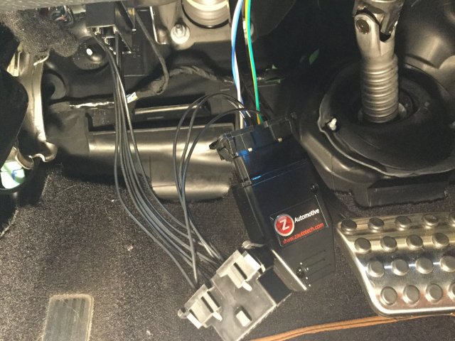

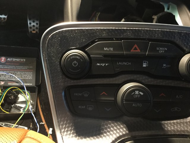

T harness plug for tuning and having the tazer hooked up at the same time. Comes with the HO tuning kit.

Are you all hooked up and HO operation available? If so how’s it running? Thanks John
I just need to put the bcm in and then it should be good to go.
1,530
13,234
Walland
21 Challenger Super Stock
Good deal I’ll keep an eye out for results. Thanks John

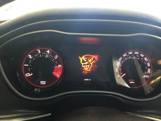

That's sharp! So basically its a Demon program. I'll have to look into it further for myself....
Yes but you can get tuning with it. Tim Barth is tuning mine.

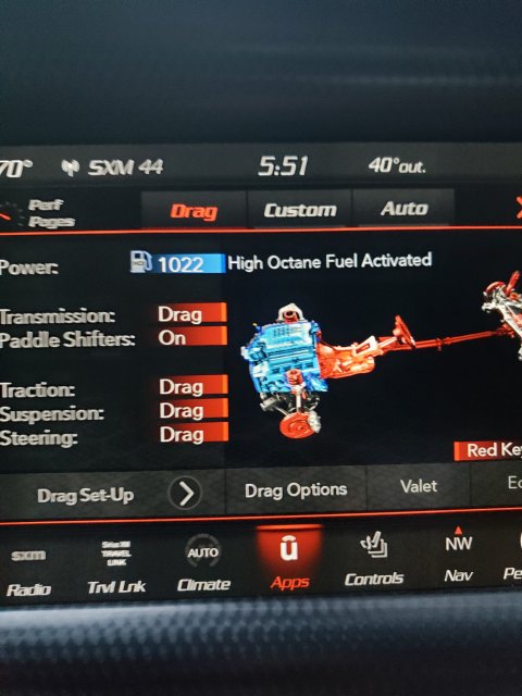

Do you know if it actually does anything to the suspension in drag mode?
16,074
50,400
Hemituner
#1284
82
242
Bayshore
2018 Demon
It invokes the Drag programming from the Active Suspension module if you select that option in our tazer.
Hope this helps
AJ

OK, let me get this right. Demon tuning for the Redeye. Fill it with 100 octane and get 840hp when hitting the HO button, just like the Demon. No warranty issues at all because the dealer can't tell the car is tuned.
if accurate, I'm all over this.
