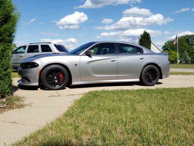

Anyone know if you can get a 17 or 18" wheel on a 21 charger redeye? The calipers are really big and I don't think it can be done without a brake conversion of some kind. Wanting to put a drag radial on it is why I'm asking.

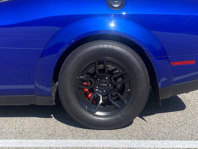

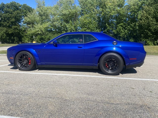

I have 17x11 with MT 315 50R17 on widebod, zero mod, zero rubbing, gone over 5k miles. They are custom from Triumph Forged Wheels. They are Devils cut style and are a good match for oem factory style.Very high quality wheels. His work is second to none!

Hunt your right “Bizzmark” @TriumphForged Wheels deserves the spotlight and glory for the custom DX5 wheels he took from a customer idea modeled after the factory wide body Devils cut but made to a 17”. Then brought to production from forged CNC machining, including knurling both inside wheel lips for added wheel to tire grip eliminating almost all slip on launch, just short of bead locks. The forged heat treated 6061 T6 Aluminum quality from precise machine to exact fit w/ proper backspacing - no shimming, no tire poke, quality is second to none and the finish speaks for itself. I will let all of folks here be the judge. Although I bought these from a fellow member here, I do expect to cross paths with Bizz for a set of Chrome Wheels maybe something like @DGatzby has although slightly different style. @Jailbreak I recommend reaching out to Bizzmark he has a wide variety of wheels in various sizes to fit most budgets and if you don’t find what you want,You dream it he can custom build it, as he did with Devils cut DX5 For wide body cars. @Jailbreak included at a few snapshots of the wheels on my car, again zero mods / end link, it clears calipers, TPM compatible on a 17” wheel. The tire I am running is MT streetR drag radial 315/R17 with no regrets. Look him up. TriumphForged.com 97ABFC70-ADB4-4D9D-B959-2CB010CAA598.jpeg 65039790-5F06-4718-B9DF-105AD3CBDC10.jpeg B26AAF15-FE90-48C7-B418-87E94232D493.jpeg A3B93DCC-F465-4867-9497-F80A15FA19D8.jpeg
