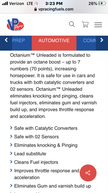

Octanium Unleaded formulated a bit different then past octane boosters, it does work well.

You're probably on solid ground if they've made all those improvements, and their claims are correct. If so, you wouldn't have a warranty issued related to the additive. I'm probably taking chances with my warranty too - really just more interested if a product like this, updated to address previous issues, works.
I'm not well-versed in these modern cars, but if the car adjusted on the fly as the octane changed either up or down, then that's pretty impressive!
