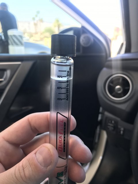

Just insert your cc and fill up the water bottle with one squeeze of the handle. Don’t fill it up all the way. All you need is 5-6 Oz or so. Then just spread out a few paper towels to dump out the fuel in the tester on the paper towels. The remaining fuel in the water bottle just dump in the gas can. Or just dump out the fuel in the tester on the ground. It’s a very small amount it will dry up. I usually dump out the fuel in the tester on the concrete away from where any cars will come close.
I try and do the best I can with the waste of the fuel.
Lol....don’t seal up the water bottle with fuel in it and throw it away.😳🙁

That is awesome. Looks easier than doing this whenever I fill up. 👍 8CA4AE2F-1E4C-4500-805A-FD36A348C735.jpeg

Read up on the accuracy of testing today’s ethanol verse years ago before all the additives where added that keep water from separating out of the ethanol to which they drastically slow down the separation process the add water to the fuel and shake wait for the separation to occur method (water bottle testing) rely on. I read enough that convinced me to use a tester that works differently. I agree it’s cumbersome, it will all just be in the units hard case soon. Open lid, put oz of fuel in, subtract 50 and instant very accurate do I put it in my tank or not results.
3,641
8,560
I do like the little bottle though, it may be worth comparing to this testers result and hell maybe go back on the bottle lol
