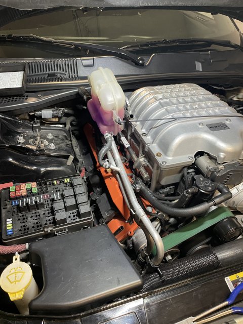

Found this image, today, and the caption said:
Remove the coolant reservoir and intercooler reservoir. Once the coolant reservoir and lines are out of the way, it's much easier... or something like that.
Also, looks like he popped out the fuse block and moved it.
This is sage advice and I think it would help, immensely.
FYI.
Bob
1,760
4,408
Ahh yes!!
The fuse box makes the fronts easier on that side. Just so you can move it around a little. Shows how much I tried to forget.🤣
The intercooler bottle I thought was a given. I should have mentioned that and the air box.😉🤔

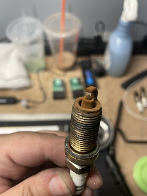

I am using that post on the “other” forums lol. So far Ive found that the previous owner was a jackass. Ran boostane…

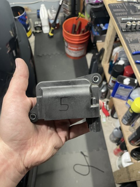

On cylinder 5, hate Dodge so much right now

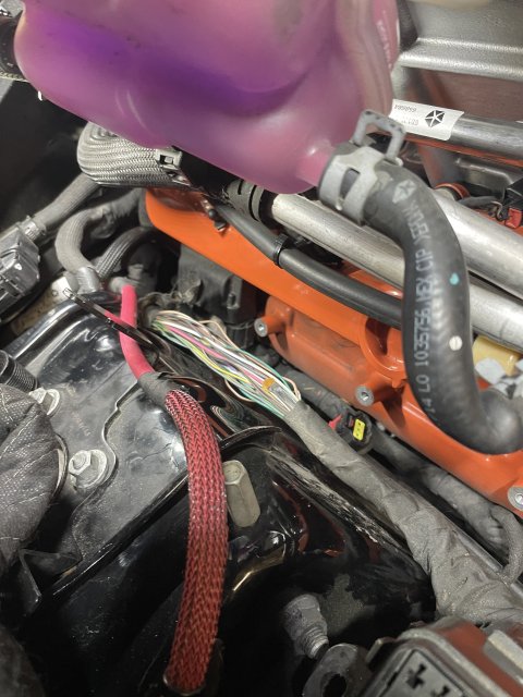

I unclipped mine when I moved the fuse box.

It's not so much needing tools as much as needing room. Once the coil pops off the plugs . You are up maybe an inch out of the hole with 4 inches of tube still in. The coil is now up against some F'ing tube or some crap. So you have to bend them out so the tubes make a U-turn before they are free.
The 2 rear coils on the right (passenger side) I found it easier to fold them out forward do to lack of space and hands that did want to look like they lost a battle in a food processor.

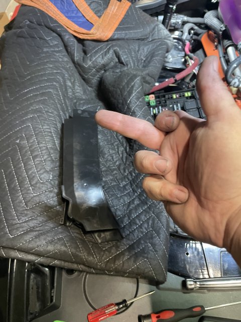

At my wits end about to cut this bitch out. For no fucking reason this plastic box exists. I dont have small hands and they look like I punched a cheese grater. 🤬
Please explain how this thing comes off.
I tried, but did t want to break any tabs.

Oh no I won. Fucking dodge heat taped it in. Clips are in the body, have to go into fender well.
Not going back in. I will heat tape the wires and then zip tie to the body.
Fuck, piss, shot, cock, cunt do my hands hurt.

30 seconds later after chugging a cold one.
4,129
10,396
Thread Starter #40
All the room now.
