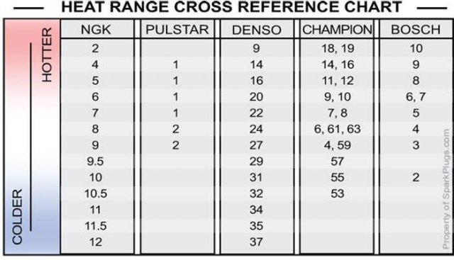

Resurrecting a dead thread? Im potentially seeing 18-20 psi now. Saw 18psi on a quick blip. What is the appropriate plug range and gap for this?
20,159
Nice chart.

So if I remember correctly - the stock plug is Bosch heat range 7.
The NGK heat range 7 is 1 step colder.
