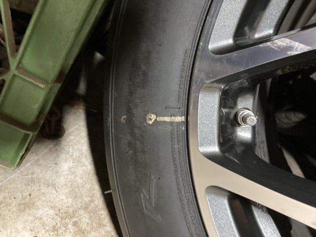

My 17” MT ER’s were slipping on the Racestars to the point where they were so out-of-balance the car was shaking like crazy at the end, obviously losing speed because of it. I called MT and they said “some guys use Aqua Net”.
So I bought a can of original (pink) Aqua Net and brought the mounted tires to a local HP shop. I had them remove the tires and I scrubbed the bead of the tires with Awesome cleaner and a scotchbrite pad until they were clean and had fresh rubber exposed. I rinsed them, let them dry then wiped them down with lacquer thinner.

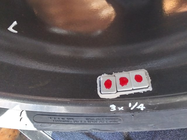

I gave the wheels to the shop and had them balance the wheels only, no tires. I marked the placement of the wheel weights and photoed them. Then I gave the shop my wheel weights which were a different color to use to balance after the tires were mounted. Marked and photoed them.
The purpose of this was if the tire slipped, I could shift the “tire” weights without affecting “wheel” balance.

I do not know how many runs I have made with these, maybe 30? 40? Most runs in the 10.0-10.2 range, including my best at 9.993. They have not budged!
Problem SOLVED!!!
