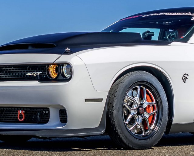

Okay!..... first a trip today to Phoenix to sprinkle some stinky sauce on her and it’s off to old Famoso Bakersfield to run the west coast Hellcat shootout on Saturday. Projected weather is for a sunny 63/32 and a sticky track. After the race it’s off to Calimesa, Calif to install the 4-link. 26AE0826-EC52-4DE1-9BAC-54FA45F7C2D7.jpeg 7953B285-5582-4502-9524-7C29BFB49384.jpeg 96D2440E-ACA5-4D4A-B14D-F14FD1D925F2.jpeg

Okay!..... first a trip today to Phoenix to sprinkle some stinky sauce on her and it’s off to old Famoso Bakersfield to run the west coast Hellcat shootout on Saturday. Projected weather is for a sunny 63/32 and a sticky track. After the race it’s off to Calimesa, Calif to install the 4-link. View attachment 31257 View attachment 31258 View attachment 31259
Marc what hood is that ?
