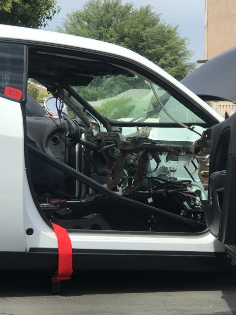

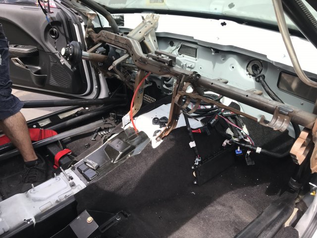

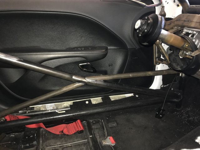

In case you’re wondering what’s behind there…. Not much anymore 🤓 53117169-DDA5-4AB0-B746-9A687A80497A.jpeg 95493775-80DC-40F4-BF00-5DFC9FBD4570.jpeg

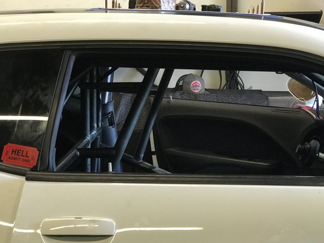

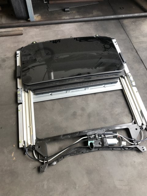

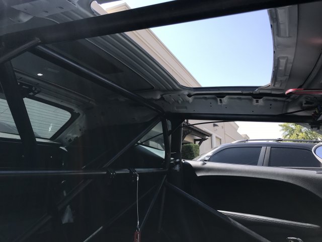

Sunroof! What you think it weighs? We can settle that question once and for all. E21E5B58-DB74-42C7-BC01-F84EAE08EDBB.jpeg 27FC08C6-3C7F-4E2D-91C8-088F9BB5FDD2.jpeg

That looks like at least 100lbs of roof.

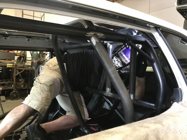

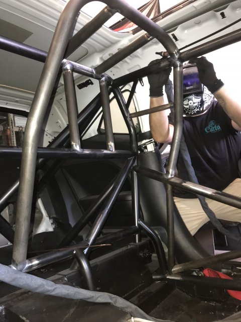

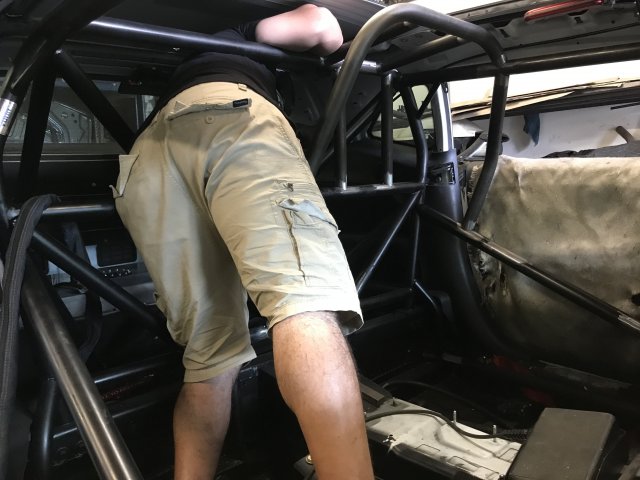

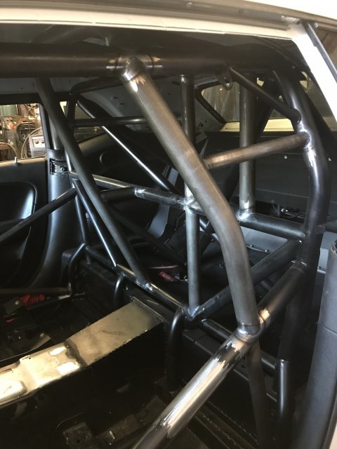

And I wonder why I have a bad back 😵‍💫 DBA633E3-78F1-4E2D-AA2D-0DB60469A854.jpeg 6CF53963-5F45-403D-B576-1AFBC0C2480E.jpeg CCC99833-E936-4B71-8353-A99D572F84A9.jpeg

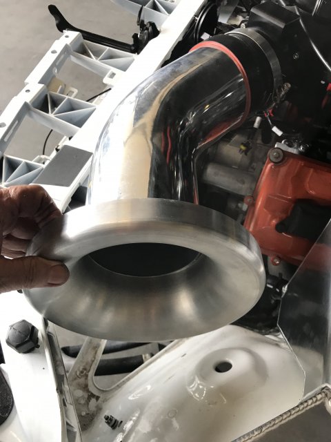

Any pics of the intake system you will be using? Or is the velocity stack gonna be on it permanently?
Looks great man. I think it looks 10 times better than the 4.5 Whipple. 👍
Still have to weld the stack to the tube but here’s a preview… DD9AA78F-CED0-4D47-ADD6-AF008529B922.jpeg

looks like the Bwoody inlet cone.
It’s from Vibrant. I don’t think Bwoody makes one that big. The tubing is 5”.

It's coming together nicely Marc, that did look heavier than it is, the sheet metal that's replacing it can't weigh too much ? .... maybe 3 > 5 lbs.

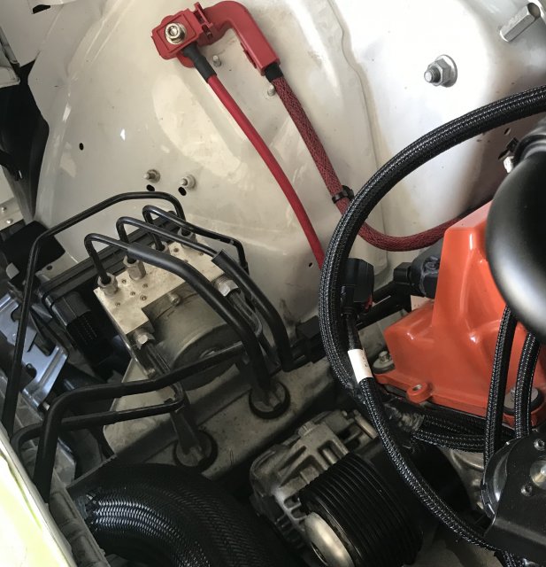

Beautiful car and equipment Mark! I have a couple of questions if I may:
Are you going to weld up the sunroof hole or put in a factory sheet metal replacement roof panel?
Are you going to take out all the ABS module and associated lines?
Which fittings are for water entry and which for exit in the IC housing?
Sorry, I’m really into small details... 🤔

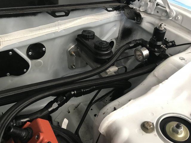

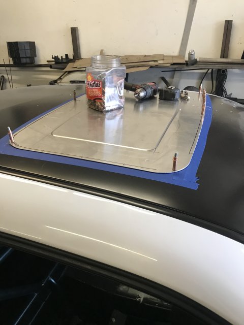

The sunroof hole is being covered with at aluminum piece that is riveted in place. The brakes are manual booster now so no abs. The two outside lines are in from the icebox and the center line is out. Some more pics…. 24924D66-5E11-46CE-8EAA-A10E006D519A.jpeg 475881E0-3FE0-4314-AEC5-4ADC48D7EF7B.jpeg 7AF6C66A-5462-4191-8B67-9A536B594640.jpeg

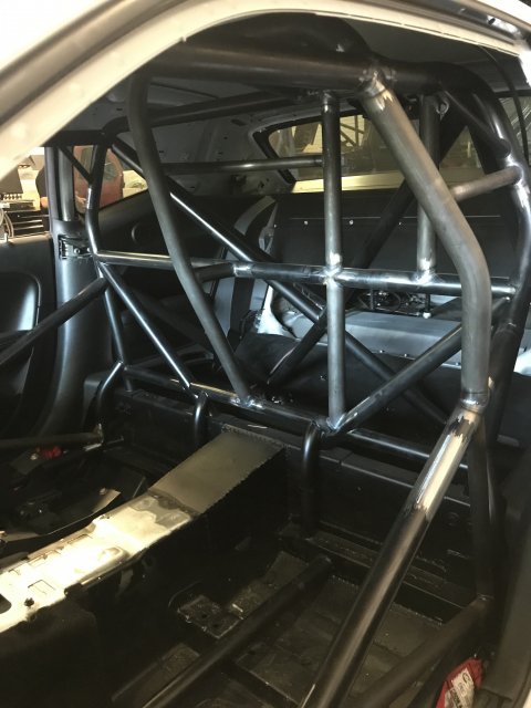

It’s getting tight in there 😂 A62DA6E4-3A22-425A-8592-932BE8383AC4.jpeg 4C6DC47E-7AD6-41FC-9398-2E725BF06065.jpeg 2811F92B-9853-4430-8D0F-13D48880AC56.jpeg C8682BA3-70C9-450D-8372-87CEB0D08FD3.jpeg
