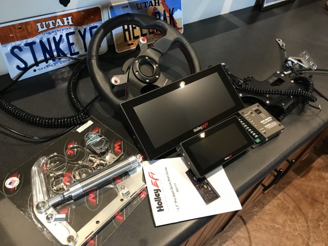

More parts 😵‍💫. We’re in staging to get this thing finished and ready to race MATS at Las Vegas in March. Still a pile of stuff left to be installed but …. It’s the cool stuff. Going with two Holley Digital Dash setups for a full array of info visible full time. The RPM related functions will be running thru a Dedenbear RPM Switch and the shifter and both ends of the chute will be air. Included is the trick Motion Raceworks pneumatic chute release handle activated with a button on the steering wheel. 🤗 CACC99AE-68BE-4A36-BF8B-887FF9479008.jpeg E2FC2224-9CB9-431E-8A0E-7BFAC1836A2F.jpeg 405C5333-502C-4180-AB17-1BB0157C128A.jpeg 52332E0B-BA12-4B75-BFD1-C2BF45B10AD0.jpeg

Looks nice, top notch, March will be here b4 you know it, I'm in the front row [popcorn]
Is one for engine vitals and the other for watching movies ?

You name it…. You can see it in real time. The Dominator coupled to these display devices is amazing.

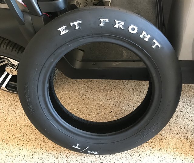

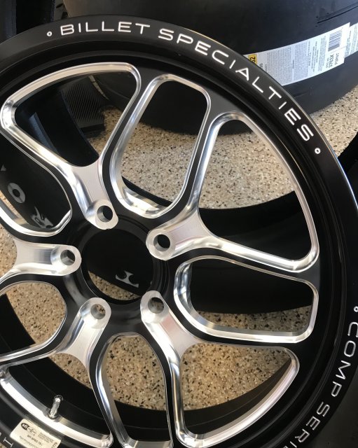

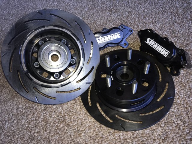

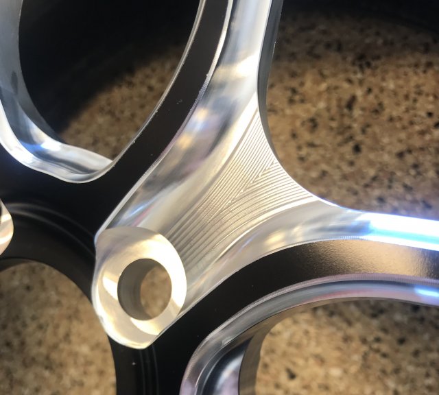

The new super light Strange front brakes I decided to go with are not available in the 115mm lug circle that we suffer with, so to do it right I had to replace my front wheels with the common 4.5” pattern instead. I was planning on staying with the 18” Billet Specialties Winlites but… 10 to 12 weeks out on a new set of those. Surprisingly… they had the Comp 7 race versions in stock in the 17” size. This is a super light race only wheel that looks like the Winlite but only weighs 10 lbs. They are absolute jewels! Combined with the M/T ET Frontrunners the total weight of the wheel/tire combination is only 22 lbs. That is less than just the M/T Sportsman tire I’ve been running. Changing over to the DragPak brake combination with these wheels and tires will pull nearly 100 lbs of un-sprung weight out of the front. 👊 39345B26-7C0D-4A9B-9856-0593C3FF6B12.jpeg 4B91E29D-F1F1-4578-A364-10EEED4B3687.jpeg EFC06258-B925-4681-9AD3-97F616BFAB7A.jpeg F0BE9568-49BF-4AE4-910D-B95FF8F3765F.jpeg FFFE914C-5606-473E-A2C0-BABEAA856A95.jpeg 8D9C1802-64EC-4601-9290-131F146BAC06.jpeg

Marc, those look badass!
Thanks. I think they will really look hot with the Strange DragPak brakes behind them. The rolling weight that will be coming out of the car will show up on the time slip. 756EFAC1-8D89-44A2-B307-25D4E2C13C4E.jpeg

The new super light Strange front brakes I decided to go with are not available in the 115mm lug circle that we suffer with, so to do it right I had to replace my front wheels with the common 4.5” pattern instead. I was planning on staying with the 18” Billet Specialties Winlites but… 10 to 12 weeks out on a new set of those. Surprisingly… they had the Comp 7 race versions in stock in the 17” size. This is a super light race only wheel that looks like the Winlite but only weighs 10 lbs. They are absolute jewels! Combined with the M/T ET Frontrunners the total weight of the wheel/tire combination is only 22 lbs. That is less than just the M/T Sportsman tire I’ve been running. Changing over to the DragPak brake combination with these wheels and tires will pull nearly 100 lbs of un-sprung weight out of the front. 👊 View attachment 63628 View attachment 63629 View attachment 63630 View attachment 63631 View attachment 63632 View attachment 63633
Sucks to have to buy all new wheels but the speed you are going probably not a bad idea. I'm not going your speed but would have still had an issue with the wrong bolt pattern even that close.
You saved some weight though:p

Thanks. I think they will really look hot with the Strange DragPak brakes behind them. The rolling weight that will be coming out of the car will show up on the time slip. View attachment 63634
Marc, I wonder what Strange says about using that front brake setup on a car that is 4000lbs with driver? I have that setup but not sure how well it would work on my car being that heavy still.
