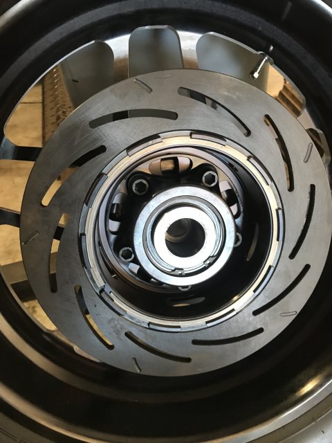

Yeah as it it turns out it was really the only choice at this level. The 18” Winlite is14 lbs so it came out to a total of 35 lb difference for both front wheels and tires combined. 35 lbs rolling weight is actually more significant then it sounds. I’ve heard it’s actually worth X times the actual weight due to needing to accelerate the rolling mass of the wheel and tire. Of coarse the brakes are also going to be a part of that, but the tire weight on the outside of the circle is the biggest factor.

Marc, I wonder what Strange says about using that front brake setup on a car that is 4000lbs with driver? I have that setup but not sure how well it would work on my car being that heavy still.

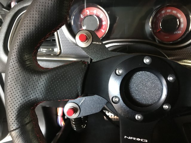

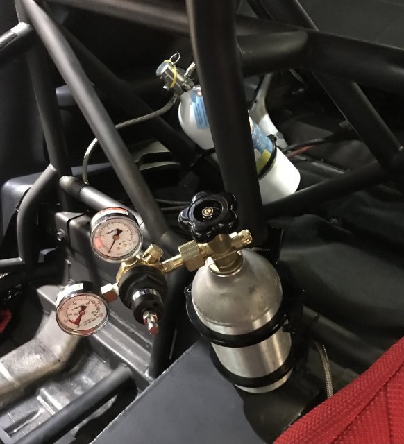

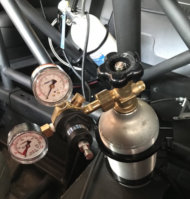

My target weight is 3700 lbs. Thats still a lot, but not much more than the FSS Dragpaks. I still would not want to depend on using them without a chute. I know they’ll do the job if they have to, but to put them to that task full time would kill them in a hurry. I just got a new air launch Pro Stock chute to replace the old pilot chute type I had. This one will launch using a button on the steering wheel. D6066325-7325-4DB1-8D34-CFFCB499D8BD.jpeg 2C598D03-D7FE-4941-A4C6-650320D16FAE.jpeg

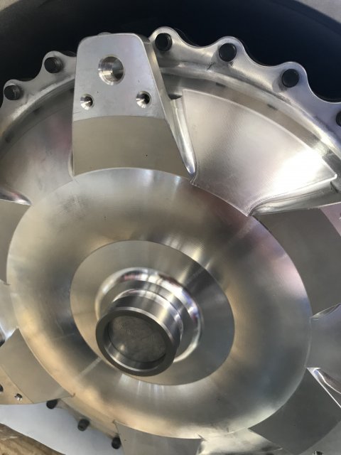

Is that a Coan Convertor?
Neal Chance. As I’m sure you’re finding out…. When you step up one thing…. it pushes you into needing to do something else. One of the biggest performance pieces with high level drag cars is the converter. One of the other cars in the shop (Brian’s B5Redeye) just up graded to a new Paramount T400 and this Neal Chance Converter. My trans is a Coan and the converter will need to be upgraded to hang with Brian. Coan has their light weight billet bolt together units that will compete with that and I will need to talk to them to see what they can do for me. He’s doing everything he can to keep from being no 2 in the shop 😂 939D085D-D127-4C14-964C-6640B1C85221.jpeg

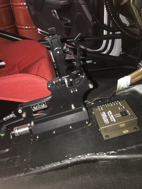

One piece at a time…. New in shop CAD fab’d shifter hardware. Came out nice 😊 9533197A-3A20-4621-8AA8-5B09D89AB8E0.jpeg 033F4698-6C9F-43A5-A78C-8CC6890A60CA.jpeg

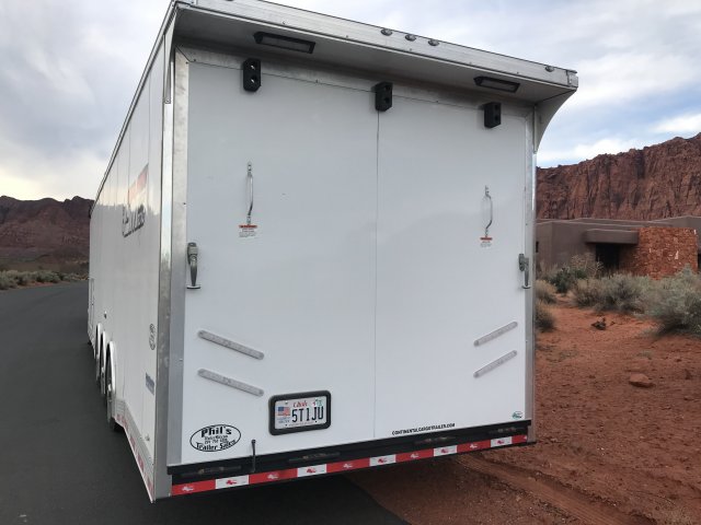

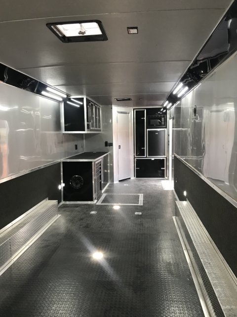

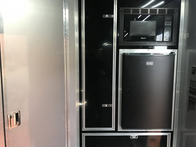

Race cars need serious trailers 😁 5C15464C-1094-4F40-8304-BA6C4F69FBB4.jpeg F3BE8F7E-7D90-41A0-8B35-3A50D562BB50.jpeg C0803090-E73F-43A7-9C1D-E2F4D83A8F4F.jpeg 54791FB5-A739-44EA-8E14-F8AB78CD2E97.jpeg 7A716387-8CF2-4689-9D26-3B790A7A6C65.jpeg 39E7D282-069E-4575-B6C4-9E58CC5C74F4.jpeg B58B357D-1A97-4356-B736-C8290EAD07DC.jpeg E3C10CE5-4C06-4D55-9F8F-9400122E814C.jpeg
