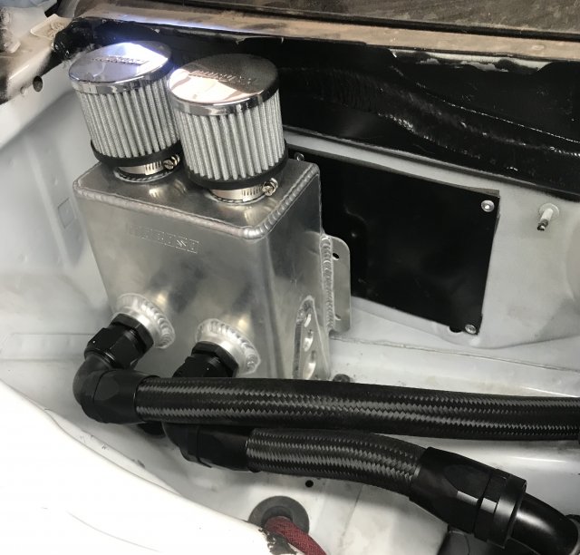

Lol. There is just so much work 😵‍💫. Believe me…. I spend a portion of every day asking myself why I ever thought this was a good idea. I made the decision to do everything as nice as I can, so when it is finished, it will be a quality piece. I’ve also been spending time at the rear redoing the fuel tank setup. Modified the facia and will be adding a custom aluminum cover that will dress this up and improve aero at the rear. 9E79477A-B080-42BF-B1CD-B1EE04D9013D.jpeg

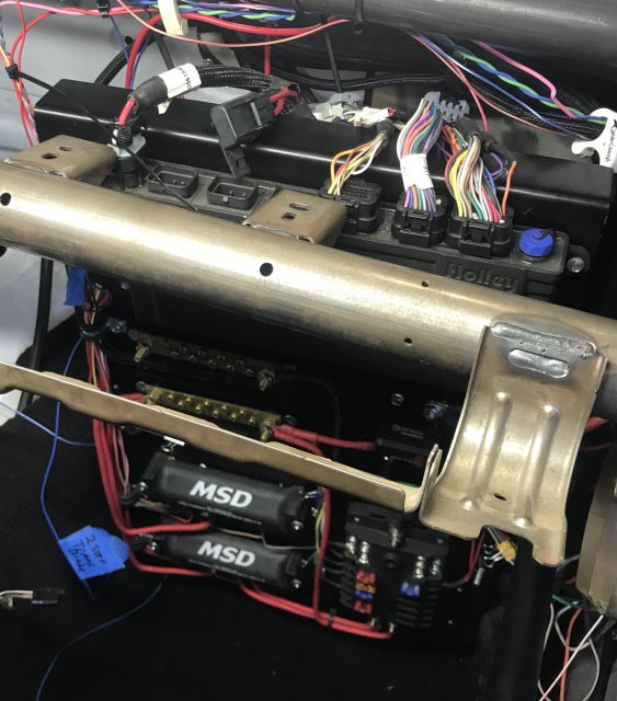

Just one picture but it’s a BIG one. The electrical panel is done. Harnesses are all connected and just some switches and lighting left to connect. Start up is getting close 🙂 816414F8-03D7-4FE3-9E9F-164C5E13A9C2.jpeg

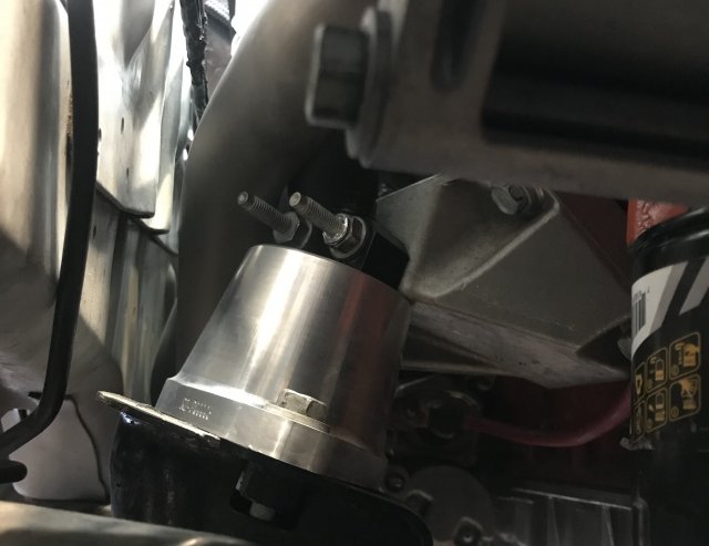

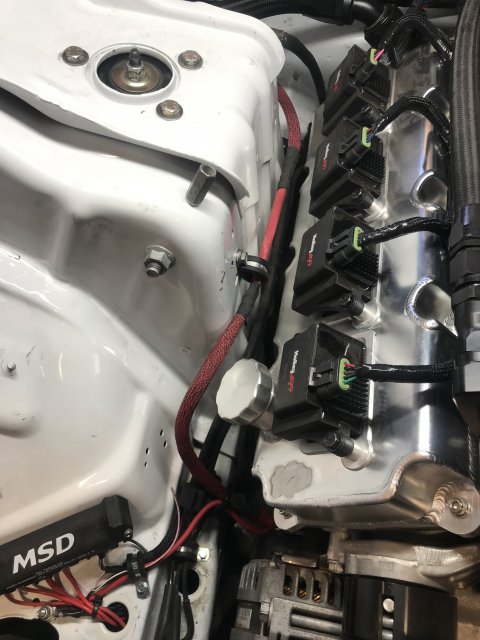

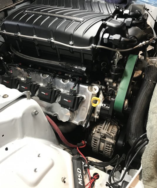

Just about ready to fire. Wiring is 99% done. Shifter is working. Billet motor mounts are in. Belts and pulleys are set. Changed the front coil overs. Just need to install the dash and set up the digital displays. 31C9507E-7CC3-4C2B-B4F2-8A8765D833E6.jpeg A1EB0077-94C6-41B8-99E1-7EF821560DEF.jpeg 27E298DB-8FC5-4A9F-8ECD-D88BD116962C.jpeg 42D10E33-78D9-4959-9DFD-EDABF5A7CC5B.jpeg B877CFC3-3221-4ACD-8AAB-FC0D2E3DD3B4.jpeg 48FDD648-A8DB-4685-B96F-393C16AFC74D.jpeg F7735770-EDA7-4A95-B89E-7214CE9667D7.jpeg D0BB3163-D98B-4D3C-9CE5-55C7612CEF1F.jpeg 7222D20D-3911-4FD7-B705-A2E88B4C7ABC.jpeg C87A1BC2-3879-456A-9432-215F72682BBB.jpeg

4,381
10,904
What made you decide on the 3.0 upper? Don't want to risk spinning it to hard? I'm surprised you didnt go 2.85
3,626
11,700
Thread Starter #1,135
I had the 2.75 in one hand and the 3.0 in the other 🙂. The blue car ran the 8.0 last year on a 3.0. We decided considering that so much is new, we would sneak up on this rather than go yahoo on the first outing. It’s possible we might be on the track this coming Friday night. Plans are to end up with the 2.75 and we are fabricating a idler pulley bracket that will move that up to increase the belt wrap for that.

Unfortunately we can’t directly post videos here, so you’ll have to take my word for it…. It’s running 🙂. What a ordeal! With all the Holley Harnesses plugged in, the big moment was at hand! 3, 2, 1….. Nope. No juice to the injectors 😒. After hours on the phone with a Holley tech (walking through changing pin assignments in the injector harness because they were wrong)….. Yes! A couple more hours on the laptop, massaging numbers and colors…… it starts and idles like there was nothing to it. Apparently the harness SNAFU is a known problem for the Mustang guys. They use the same harness and he spends all day trying to calm them down. He said we were the only Mopar he knows of doing this. He said those Dodge DragPak guys are in their own world and don’t share. 😂. Anyway.. the stress of figuring stuff out is just about done and the fun part of making it look like a Hellcat again starts. Test fitting the dash and mounting the digital screens starting now 🙂 046DB693-E327-4C83-BF33-97C00B90C7BA.jpeg
