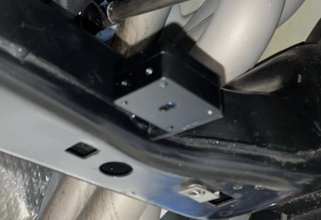

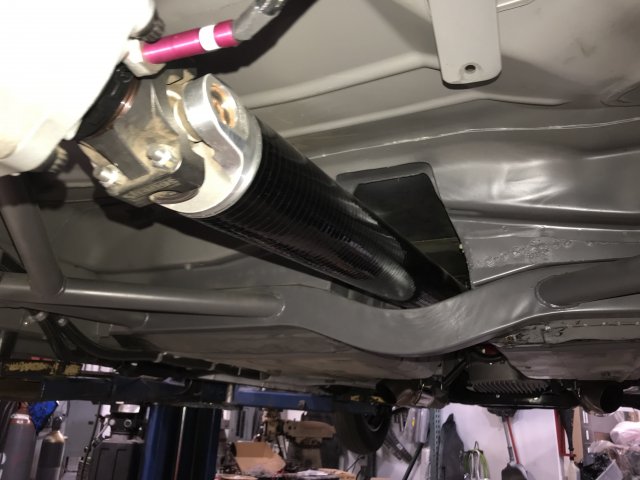

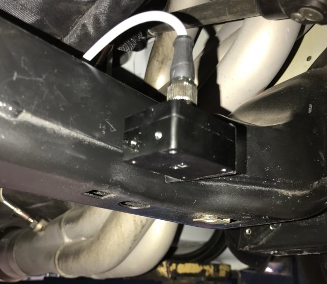

Good news is…. All of the traction and wheelie control sensors are working. Two long days of wiring and programing these gizmos resulted in some interesting and fun stuff to play around with. With the car off the floor, turning the rear wheels resulted watching the computer show as little as a fraction of a mph. We got it up to three mph spinning them by hand. The ride hight sensor is a infrared laser that ended up pointing at the floor from a distance of 5.5 inches, fixed to the front cradle. Just rocking the front up and down resulted in showing the movement in fractions of a inch. As it turns out…. The front wheels leave the track at 12 inches so we get 6.5 inches of front end lift before the wheels are airborne. The bad news is…. It’s raining in Calif and our rental had to be pushed back until next Friday. It hasn’t rained there in like six years, and on the two days we want to be there…. Go figure. 🫤. 422031E3-BBF4-431C-9C31-AA7CE9700E5A.jpeg C266FDAE-ADB3-40A8-90B7-9582FFAE7298.jpeg DA4C7214-3D72-4199-8247-1A1D78883C88.jpeg 43F53D7D-498A-4213-8BDB-FFE35027AEF9.jpeg

Good news is…. All of the traction and wheelie control sensors are working. Two long days of wiring and programing these gizmos resulted in some interesting and fun stuff to play around with. With the car off the floor, turning the rear wheels resulted watching the computer show as little as a fraction of a mph. We got it up to three mph spinning them by hand. The ride hight sensor is an infrared laser that ended up pointing at the floor from a distance of 5.5 inches, fixed to the front cradle. Just rocking the front up and down resulted in showing the movement in fractions of an inch. As it turns out…. The front wheels leave the track at 12 inches so we get 6.5 inches of front end lift before the wheels are airborne. The bad news is…. It’s raining in Calif and our rental had to be pushed back until next Friday. It hasn’t rained there in like six years, and on the two days we want to be there…. Go figure. 🫤. View attachment 88770 View attachment 88771 View attachment 88772 View attachment 88773
Some high tech gadgetsšŸ‘
Yeah they are. The more we’re learning about this world, it is astounding. Being able to balance track conditions with the power necessary to get down the track efficiently (and safely) is a challenge. We’re working with some people who specialize in this stuff with the X275 class and no-prep cars, and it’s amazing to watch one of these 3000hp cars run 3.xx 1/8 miles without wheelie bars. You have to see it to believe it 😳.

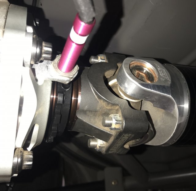

Good news is…. All of the traction and wheelie control sensors are working. Two long days of wiring and programing these gizmos resulted in some interesting and fun stuff to play around with. With the car off the floor, turning the rear wheels resulted watching the computer show as little as a fraction of a mph. We got it up to three mph spinning them by hand. The ride hight sensor is a infrared laser that ended up pointing at the floor from a distance of 5.5 inches, fixed to the front cradle. Just rocking the front up and down resulted in showing the movement in fractions of a inch. As it turns out…. The front wheels leave the track at 12 inches so we get 6.5 inches of front end lift before the wheels are airborne. The bad news is…. It’s raining in Calif and our rental had to be pushed back until next Friday. It hasn’t rained there in like six years, and on the two days we want to be there…. Go figure. 🫤. View attachment 88770 View attachment 88771 View attachment 88772 View attachment 88773
a laser/light on the drive shaft?
Does that count revolutions per pass?
That’s what is called a Hall effect sensor. It is counting the magnetic pickup points on the ring that goes around the driveshaft yoke. There are 16 of them. The computer (Holley EFI Dominator) calculates the rear wheel speed from that data. It also knows how fast the car is moving due to the G-meter sensor and so… it knows if the wheels are ā€œslippingā€. It will pull timing until it determines that has been corrected and start adding it back. This all happens in milliseconds so you can’t even tell it’s happening.
