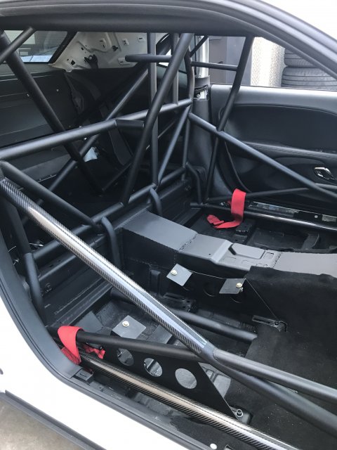

That is a stock frame. All the way from the front crash bar to the rear. I’m comparing it to a tube chassis or back halved car that actually has part (or all) of the framed removed. Also.. note that the shocks and springs mount in the stock location.

As far as the chassis goes with mine and this blue car… that 4-link was right out of the 2015 DragPak program and is sold by the guy who was originally involved with that. The stock frame gets tied together with a number of bars in the floor that are a part of the cage. The main one being what is referred to in NHRA chassis speak as the #1bar. That is the rectangular truss that runs from rail to rail in the floor. When the cage is cert to 7.5 or faster, the main hoop has to tie into that instead of plates on the floor. That #1 bar is seen from under the car in the previous rear end picture. There are also the sill bars that tie the main hoop at the bottom to the base of the bar coming down behind the dash. Picture is worth a thousand words so….. a lot of chassis stiffening going on and that’s a good thing. The 4-link needs that for a solid triangulated base. Speaking of that older DragPak design. That was a NHRA requirement that forced them to use the stock suspension points. It uses what’s called a panhard bar for centering. That is obsolete now and I’ll be replacing that with a wishbone that Redeye Racecars is making for me now. I’ll also be modifying the link attachments to get the instant center weight transfer dialed in. IMG_2270.jpeg IMG_2274.jpeg

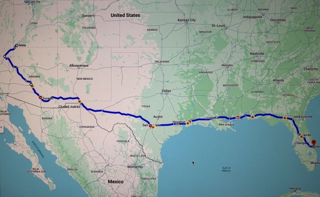

More decisions 🤓. In two weeks I’ll be taking a drive. In ‘what if’ discussions with Jim Golden at Redeye Racecars, we are going to use my car to develop a plug and play twin turbo setup for those who don’t want to go the underside mounting route. This will be a high end package that you will be able to order from them for mounting twins using a intercooled intake with the forward facing throttle body like mine, Cornerstone, etc. While there, we will be making some changes to my rear suspension to suit the small tire classes I’m planning on running. I’ve been friends with Jim for years now and he is very excited about having a hand in our project. This will free Adam up to work on his new machine shop endeavor instead of shutting everything else down for me and him to do nothing but work on my car. The Spankintime race at Famoso next week has been postponed for weather and will be rescheduled for next month. Looking forward to some of that Florida winter weather 😊 IMG_6027.jpeg IMG_5501.jpeg
