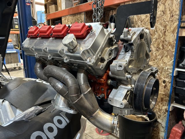

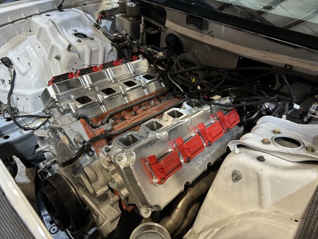

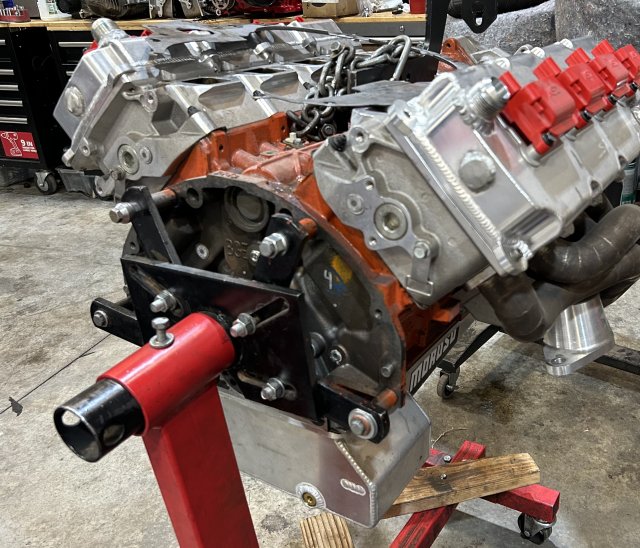

Time to to put a new motor in this thing 🧐 IMG_7967.jpeg IMG_7953.jpeg IMG_7954.jpeg IMG_7955.jpeg IMG_7968.jpeg IMG_7958.jpeg

Was that one just for mock up? Aluminum block going in?

That’s my old 426 that has been the heart of the car for over five years now. One of the first Hellcats in the eights five years ago. It has been sold and will be freshened and put into a 1970 Dodge Challenger with another 3.0 DragPak Whipple. The aluminum Hellephant is being built now and will be replacing it with the turbos.

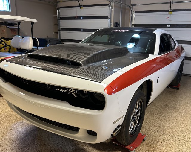

Finally back home in my garage and ready for some major detailing 🤗. Running fluid lines and wiring and lots of tweaking to get it 100% ready for the next time it heads to the shop for the new motor. This thing has been towed over 7,000 miles of bad interstate. Survived a major hurricane in Florida. It’s been torn apart and cut on and somehow made it back better than before. It’s a miracle 🙏 IMG_7974.jpeg

Its a badass build, cannot wait to see it hit the track.

Your garage opener light looks like someone sitting in the driver seat with a helmet on 🤣. Car wants to go fast NOW

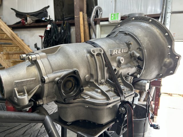

Knee deep in AN fittings at this point 🫣 IMG_8001.jpeg IMG_8002.jpeg IMG_7991.jpeg
