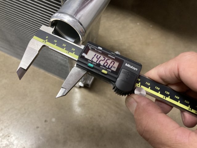

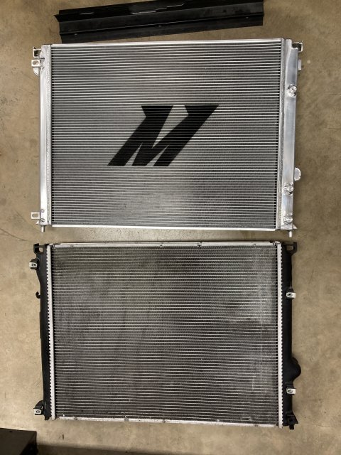

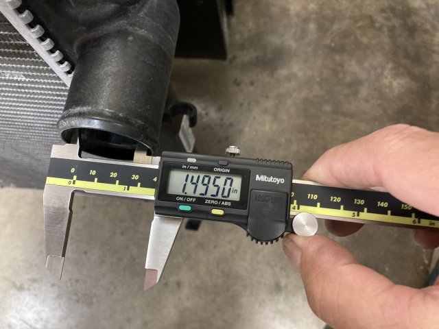

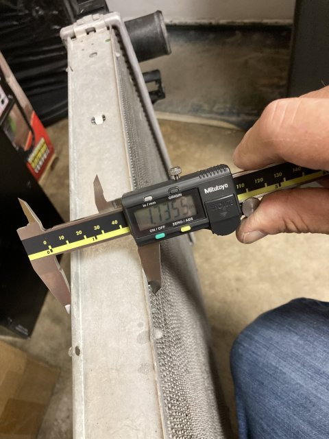

Radiator arrived last night, NICE piece. It’s back up in place and intercooler and AC condenser bolted back up to it. No installation issues so far, all mounts match right up to factory radiator. Finish her up tonight and hopefully start up and test ride. ID of inlet and out let pipe are almost .100” bigger which should help flow, OD is the same they are just thinner. It’s 1/4” thicker, uses 2 rows instead of 1 like the stock unit, does not effect fit, went right in no issues and not a fin bent going in (taped card board to it front and rear)
Here’s some pictures.

Inlet and outlet fitting OD’s within a few thousands of stock, no issues with hoses, Both where a tight fit. I think that is a different model number with the different hoses for the RT’s, 5.7’s and regular hemis not the Hellcat?

Looks like the aluminum is about 3 lbs. heavier, not bad for a stronger unit, & with a extra 1/2 gallon capacity, somewhere around 7 lbs. total in extra weight.

Yes, new unit is about 3 lbs heavier dry, which with the extra 1/2 gallon of fluid it supposedly hold should put it around 7-8 lbs heavier then stock, well worth the strength difference, hopefully it offers increased cooling as well. It’s going back together with same Tstat and it’s going to be 90+ here the next few days and I data log every mile so data logs will prove or disprove any cooling differences. I’ll post for sure

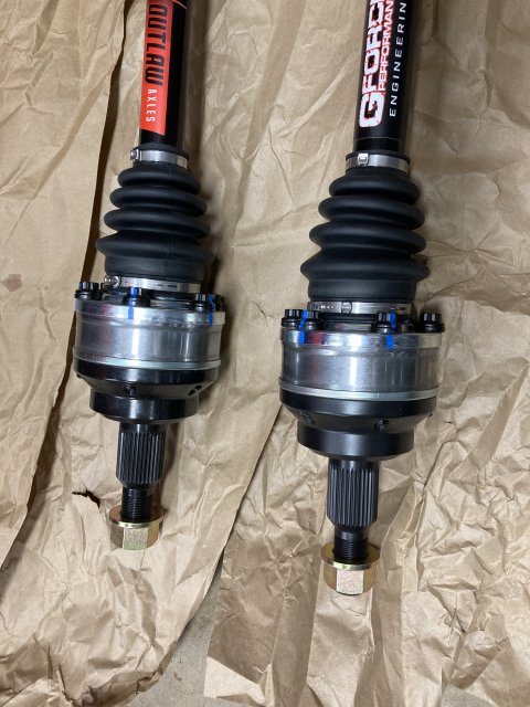

Well on E85 now and was supposed to take the car to the Dyno Monday and see what she was putting down but unfortunately Sunday night out doing some Test and Tune she told me she was making more then the Tranzilla cared to put up with any more :(. On the 2-3 shift she spun the grabbed hard and BANG followed by free reving. First thought was took out a axle or the Diff as both where making noise and where planed to be swapped out soon as new GForce Outlaw Axles arrived. Well turned out both axles and Diff where still hanging in but Tranzilla wasn’t, no gears what so ever not even reverse. After the car sat a bite tried the gears again and forth gear moved the car and thanks to the stump pulling Tq of these animals got me the mile home without complaint. Axles arrived yesterday and new Diffs been here but now it’s Tranny rebuild time. Called RSG and they have a new all 9310 material gears set 2.66 first close ratio gear set due in 9/22 so that’s going to be the next round. Being the car is moving to more roll racing then 1/4 stuff that ratio will suit her better plus it’s strong as hell, input shaft rated at 1400 ft lbs of Tq so maybe this one will survive for much longer but the original 4340 2.98 wide ratio unit that has survived over 2 years of my abuse. He’s the new GForce Outlaw axles and 3.73 Diff, that was going to be this weekends project anyways so now and trans to the list too. These Gforce axles MUCH more robust looking then the DSS Stage 5 their replacing. All ARP hardware, one piece billet splines with zero runout spline shaft to CV hub, Super Alloy CV’s that a file wouldnt even scratch, different diameter center shafts which is their anti wheel hop technology, can wait to see how smooth the new drive train is compared to what’s coming out. Tranny supposed to be ready 9/23, roll racing at Pocono coming up 10/3, that’s what I’ve been prepping for, hopefully can still make it. 🤞

From what you said and what I have seen, that is why I wanted the g force axles:)

which is their anti wheel hop technology, can wait to see how smooth the new drive train is compared to what’s coming out. View attachment 53570
View attachment 53571 View attachment 53572 View attachment 53573 View attachment 53574
Look real nice! Glad to see they have upgraded alloy on the CV joints. I'm not understanding the ant-wheel hop technology aspect though.("different size center shafts"). Too bad about the tranny.
