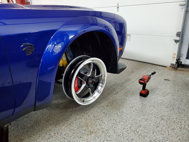

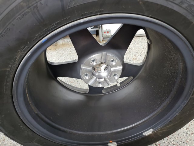

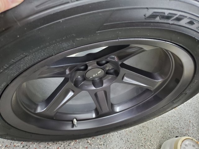

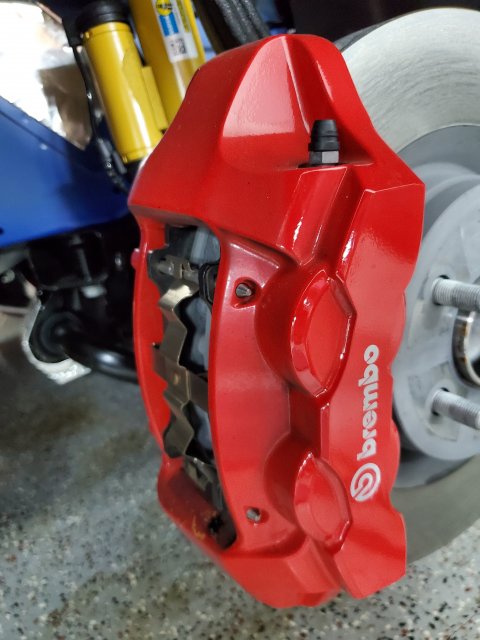

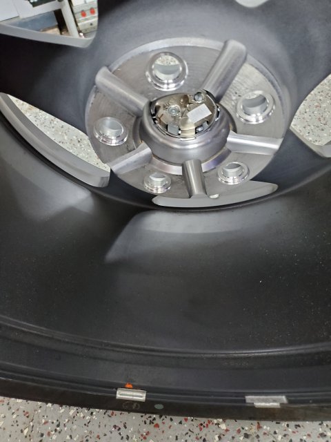

Interesting observations today while test fitting my Weld front skinnies... The stock 18x11 wheel with OEM NT05R tire weighs 60 lbs! I was guessing approx 55 lbs based on Demon wheels weighing ~22 lbs and Nitto NT05R weighing 33 per their specs. (btw yes I know my wheels are dirty)
Also, I could not find a part number on the Super Stock wheel anywhere... On the Demon wheel, the part number is stamped right near the hub surface.
And finally, the 2021 Super Stock gets the same Demon calipers, while the 2020 Super Stock has a basic Scat Pack caliper as I understand. Also, 2021 has non-slotted rotors, but 2020's were slotted.
I would be curious if anyone knows a paint code that would match up to the granite gray wheels. I have some Demon wheels on the way and I want them powdercoated or painted to match. The Demon wheels will be for a "factory appearing" drag pack, while the Welds will be for all out personal best goals. 20210912_160921.jpg 20210912_160905.jpg 20210912_160812.jpg 20210912_155331.jpg 20210912_155323.jpg 20210912_160002.jpg 20210912_155417.jpg

Curious why you ordered the HK audio as that puts the heavy subwoofer box in the trunk floor pan? I mean it does sound good, much better than the Apline audio setup.

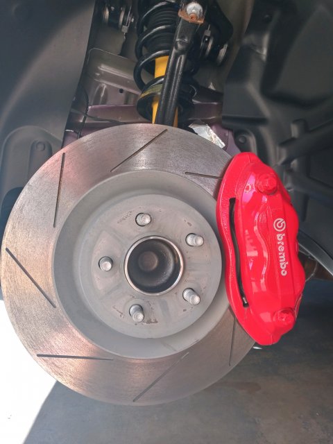

Boosted,
The color on the SS wheel looks a lot like the color on the '19 Devils rim my RE came stock with. I found a powder coat color that's very close to that. I still have two of those rims. I'll get one out and compare it with my SS wheels. If they're as close as I think I can get you the powder number pretty easily.
