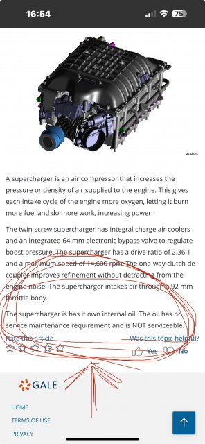

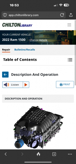

please let us know this dealer so i can call service and schedule mine

No oil lasts forever, however the oil in the IHI SC (Mobil Jet Oil II) should last a very long time.
