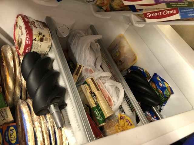

The numbers don’t come up on any searches, I’ve tried for days. I can get a seal the same ID OD and Width but no where close to the same lip design and unknown material. Google installing a Teflon oil seal, it’s easy on a tapered shaft designed for such but not on a shaft with no taper and 2 seals with 4 lips to get a frozen shaft through quickly, then do another as quickly right along side it while twisting and screwing the lobe mesh together. Remember these shafts turn 18-23,000 rpms, that’s some high surface speed for a contact seal to survive under. I made a tool to pre-fit Bonds Teflon seals correctly, will be sacrificing one fitted seal in a 275F degree oven test to see what it does to the fitted to size Teflon lip, Teflon grows like mad when heated, and if heated too much produces some really nasty for you fumes. Hopefully it doesn’t squash my plans of heating up the bearings and housing as an assembly in a 275F oven over night and then drop the frozen at minus 22F for a week rotors right in them stress free. If I can pull that off it will run forever even at 25,000 rpm input speed.

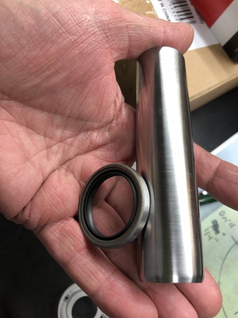

Taper tool polished to mirror like finish to not scratch the Teflon material. There’s no getting a seal onto the shaft with out it, and if made too big stretches the seal too much, sacrificed a $50 seal learning lol.

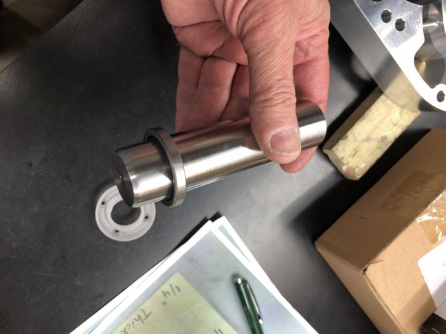

See the fine line in the shaft near my index finger in bottom picture? That’s the place to stop stretching the seal at, that shaft has a very slight taper too it. Hopefully they retain their shape at 275 for a few hours, will find out this Saturday morning lol

Seals have to go in housing before the bearings, so heat bare housing to 275F over night so it expands. Have seals and bearings in freezer for a day or so. Seals will drop right into their bores in hot housing, so will bearings, clunk right in, no pressing or stress induced, they seat with no induced stresses. Then heat the whole thing again at 275 for a few hours again so bearing bores are expanded, frozen rotors should then drop right into the bearings (first through the can’t even see them any more pressure seal and the gear case oil seal, their 2 different size seals separated by a pressure release port system and also a oil leak drain system) they set in seconds to another stress free mating of the 2 angular contact literal super precision ABEC 9 bearing pairs per shaft. Then seat the heated to 275F also Larger gear onto the driven shaft as well. Set timing, install end plate, test spin, put gear cover on, fill with oil, done. Hopefully goes as easy as it said 🤞

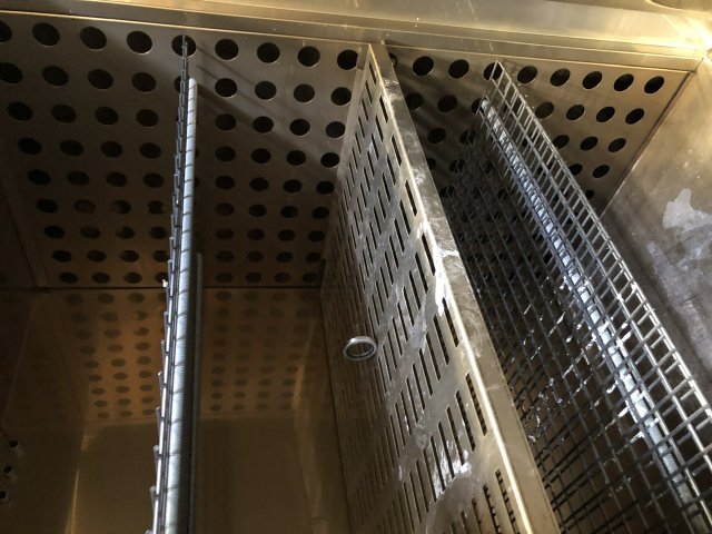

Cooking the ruined seal at 275 to make sure I don’t ruin the 4 others doing such, as their $50 each as well :(
If that doesn’t work its plan 2, 50 ton H press and make up some precision face ground pressing plugs to push evenly on ID and OD of the bearing set at the same time on room temp parts, that should work too but I prefer the thermal seating method if I can pull it off

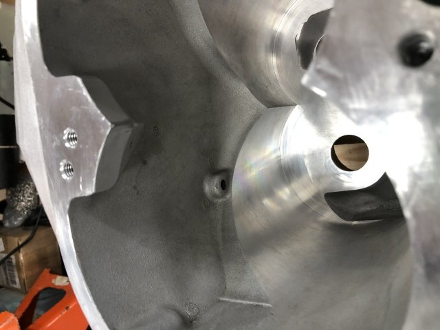

See the port in the blower inlet area? It’s connected to an area between the case pressure seals and the gear case oil seals, that area is under a vacuum and if pressure leaks it’s recirculated back into the rotors.

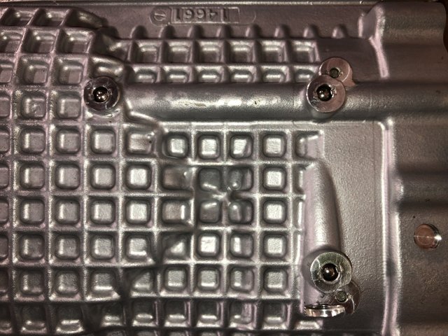

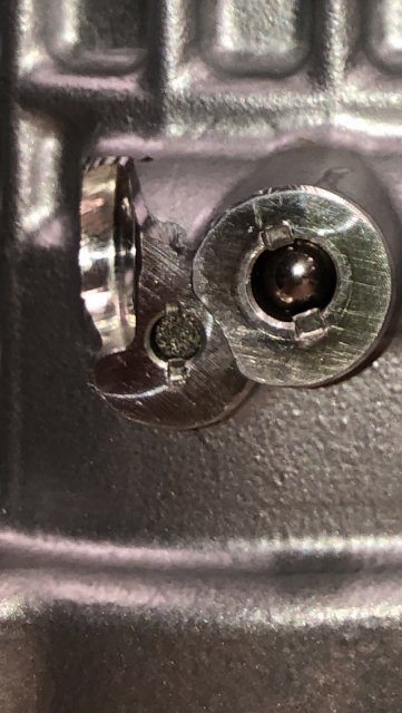

#71
Now look on the belly of the blower, there’s 2 tiny vent ports under there, next to the seal balls. There connected to an area between the pressure seal and the gear case oil seals, any oil that gets by the seals will vent out through these 2 vents. The sealed gear case vents to this area as well through a small hole in the hollow driven rotors shaft, the bolt that holds the drive gear on has a tiny hole drilled through it and that’s how the gear case vents to atmosphere. That why you always want to store these blowers level not on end, or on their sides, upside down would be ok. 8CCC92FF-9D45-4F7C-9588-C4288AA63B94.jpeg 55D5B432-2030-4331-A346-C59E577ADAF8.jpg

Word to note here on AIR VENTS on bottom of Supercharger and the addition of THERMAL BLANKETS
Be sure to cut holes for these 2 vent ports so they can do their job and let gear case breath or your risk blowing out the oil seals!!
