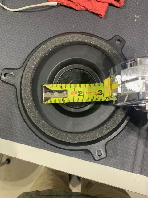

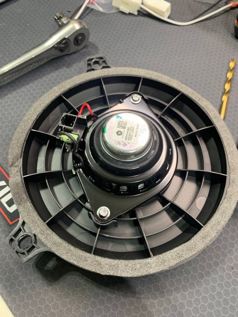

Well after completing the first step of my stereo upgrade I can officially say that my subjective observations of the HK system sucking are officially objective; the rear deck speakers are HOT garbage...
Note it is NOT a 6.5/6.75 or whatever they call it speaker; it's barely 3-inches...

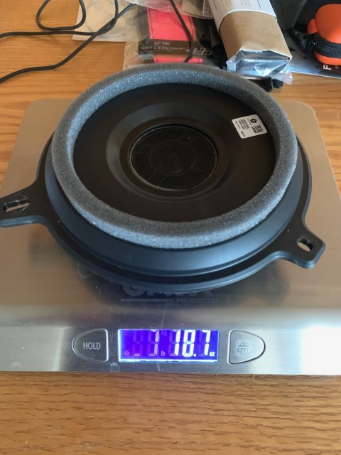

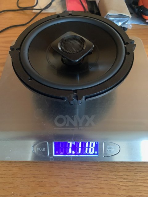

Weight is NOT everything when it comes to speakers, but the Polk DB 652s are used to replace the stockers weight nearly triple the stockers, which aren't even 11-ounces!

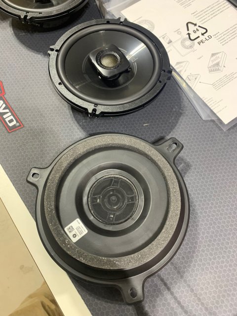

Top view comparison:

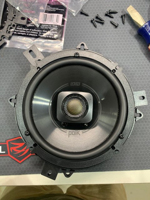

Polk with mounting bracket:
