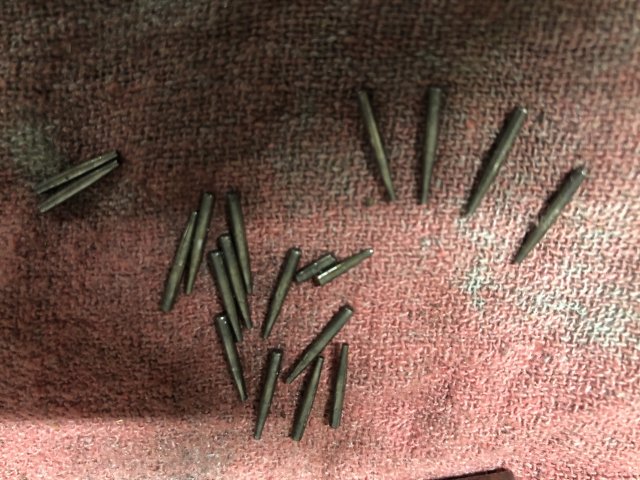

A little bit of a follow-up on the Lifter failure. The motor is back together and running again and the motor seems to have a little more power with the MDS disabled. Everything went back together good with the exception of some minor issues with the MDS disable - the PCM had to be sent to Diablo when it locked up while trying to load the tune.
I also disassembled the lifter that failed - some interesting wear was found:
C077A35D-F7F2-48E1-A784-0A3C72657D23.jpeg E32F21AF-0DC0-42E4-BBEC-2FA85741F566.jpeg
The pin holding the roller and bearings had significant wear and the roller bearings were actually tapered...
