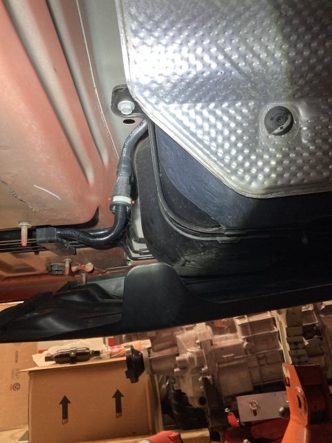

I'm talking about the rounded bend in the line not at the end under the car.
No, I think they made the bend that way to get a bigger radius as tight 90’s are more restrictive then long sweep 90’s. I don’t think it’s necked down there.

In the pic it appears it necks down that is why I asked
