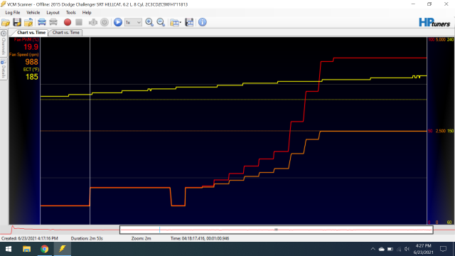

Have tools, use tools... Decide to setup a quick graph to log the fan pwm, fan speed and ECT to see if anything was amiss in the tune. 100% not the tune. As expected when I sent my tune to OST for refinement, I had the fans kick on at 185F in which they did.
Then an interesting anomaly at 192F the thermostat struggle bused, opened and then closed again it looks like:
Then from there the bleeder valve in the jet (at tdc) was able to prevent total meltdown. Waiting for the car to cool down to pull it. Gonna toss it in some 185 degree water and see if the filament moves. If not, then something else might be amiss like the pump, car is down, I repeat we have a code red, car is down!
